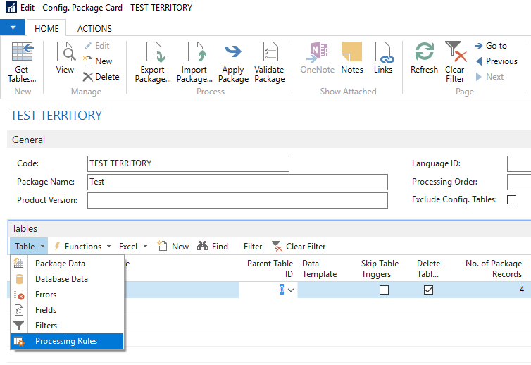

      2) Processing Rules, Action=Custom (Config. Package Card, Tables Fasttab, Tables, Processing Rules).Ā  Seen here:
      You set the Action to Custom and then need to choose a custom Codeunit that you have designed to do whatever you want.Ā  This codeunit needs to have table 8614 “Config. Package Record” as a parameter on the OnRun (TableNo = Config. Package Record) and then you can use this record to do whatever you want.Ā  The problem is that when this codeunit is called when you are “Applying Data” the records have already been inserted or modified in the database.Ā  This means we would have to use the Config. Package Record to go figure out the primary key and then go find the actual record to do the modify on.Ā  Certainly doable but a bit of extra work that I can’t imagine anyone has ever spent the time to do.Ā  Has anyone done this and do you have an example of a Processing Rule, Custom Codeunit that works with Rapid Start?
