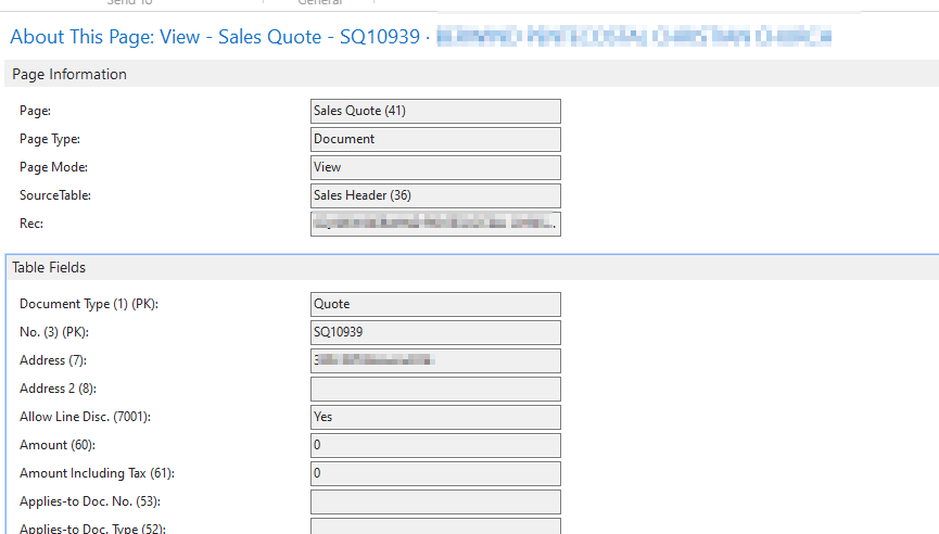

      I’m not sure which version of NAV/BC you’re using, but I know in our #NAV2016? version if you’re wanting to see that information, you’ll need to look at the report in the Microsoft Dynamics NAV Development Environment.
      It’s similar in BC, but you need to use Visual Studio Code and/or Report Builder to see the info.
      If you’re just wanting to see what fields are available/being pulled on a page, you’ll want to “Zoom” (Ctrl-Alt-F1) on a Header or Order Line to see that information.
      Luckily, Zooming works the same in all of the versions of NAV from 2009 to BC (as far as I know)

    • Kevin Brennan
      November 10, 2020 at 9:57 AM
      Hi David,
      Thanks!  This is very helpful.   We will pursue that “path to the goal.”   (I know I’ve seen Report Builder.  Not sure if we have Visual Studio, but can get if we need…)
