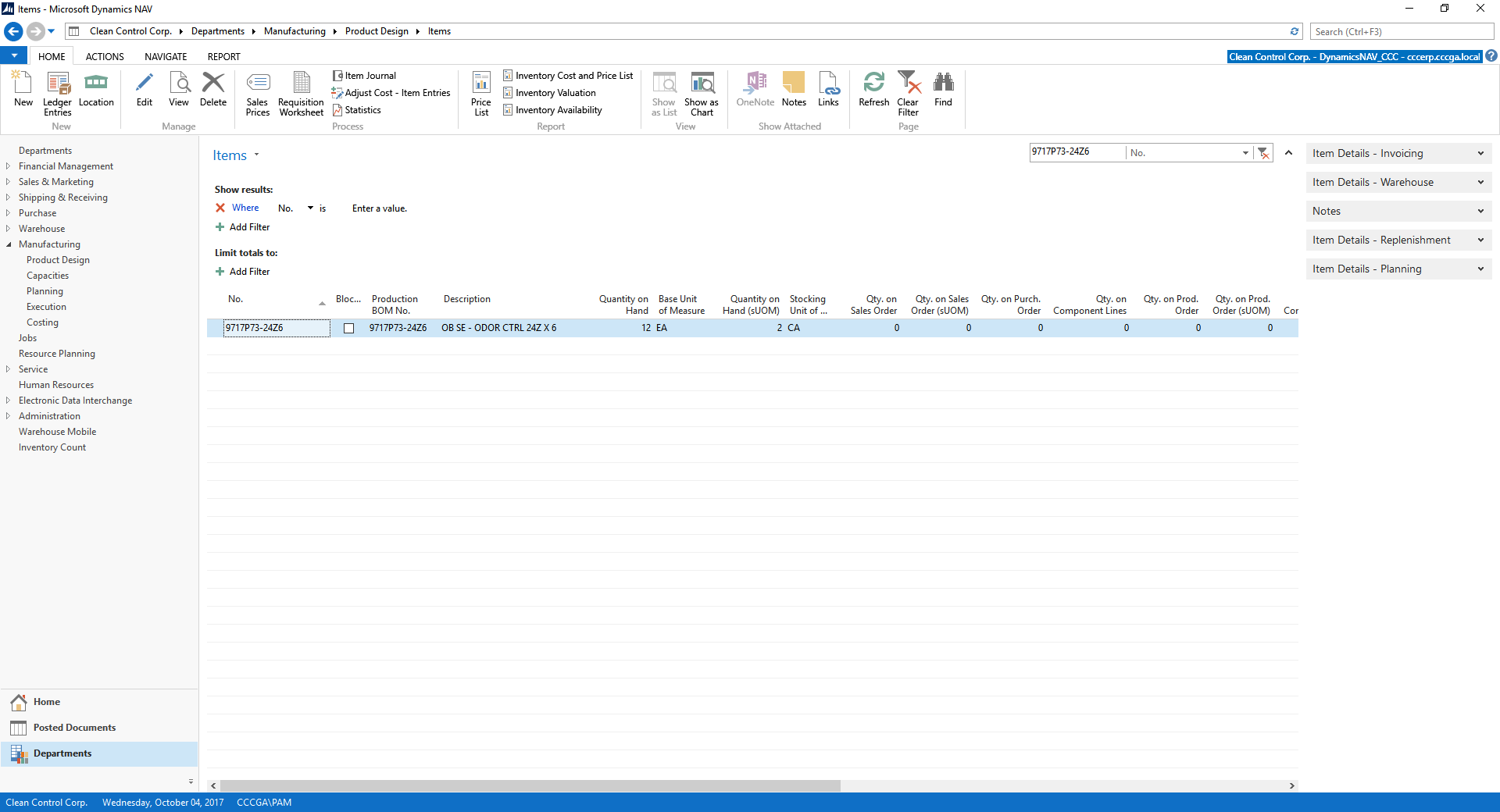

      Does anyone else have an issue where an item has a different remaining quantity in the ILEs than the quantity on hand showing in the items list?Ā  We have a few items that show a quantity on the item list but remaining quantity in the ledger entries is zero and does not allow a negative adjustment.

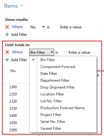

      That’s odd since the quantity on the item list should just be a flowfield looking at the quantity field in the ILE.Ā  One thing that could impact it is if you have “Limit total” set on the list.Ā  This will limit the values included in any flowfield to only those that meet the criteria set.Ā  You could be limiting by a location or one of the other filters.

      On this particular item, “Remaining Quantity” in the ILE is all zero.Ā  The Item List shows quantity on hand as 12.Ā  A negative adjustment is not allowed due to insufficient inventory.
