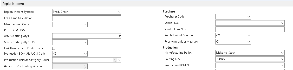

      Hi Roland – I’ve seen where the component lines do not populate the production journal when you do not have the production bom field filled in with the link to the bom number on the finished good item number. In my example below the production bom no field is blank when it should be filled in. Any chance that is the issue? I’m guessing no since you say you can see the components but wanted to confirm.

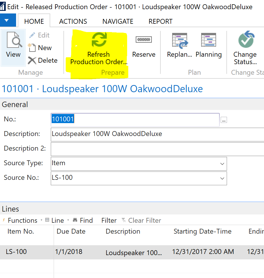

      In the production order, if you click on the production order line and choose components, do you see the components?Ā  If not, you need to ‘refresh’ the production. There is a specific button, see screenshot.. Executing this builds the production order components information that is used to populate your production journal.

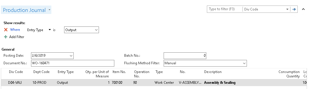

      So in other words you can “calculate consumption” in the consumption journal and the lines pull in fine but you cannot see these lines in the production journal. Any chance you have a hidden filter in the production journal that is hiding the consumption entries like below?

      your first sentence is correct. I don’t have any filters on the production journal.

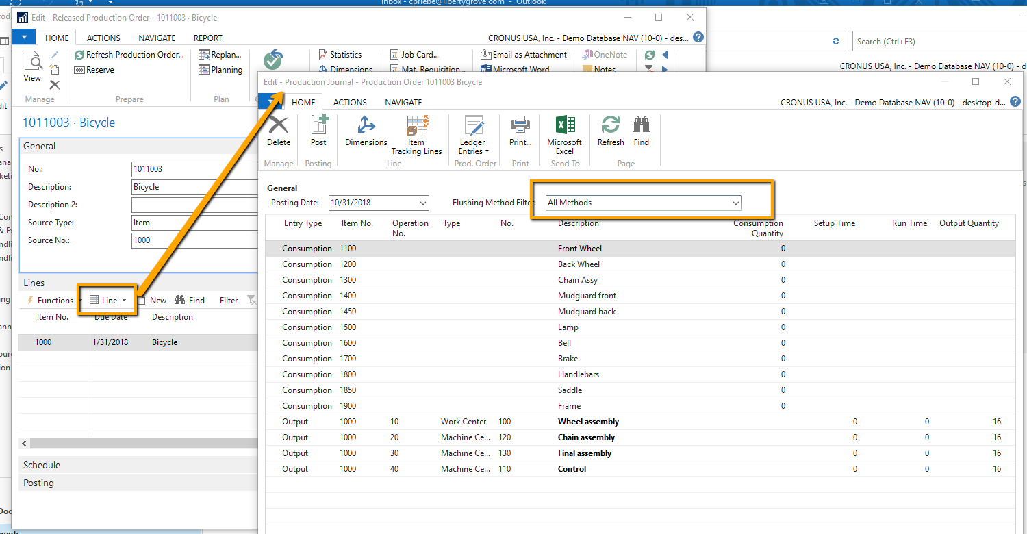

      Try changing the Flushing Method Filter on the Production Journal to “All Methods.” Do you see the lines now? I can seeion your screen shot this is set to Manual (which makes sense) but curious to see if removed, the consumption rows become visible.
