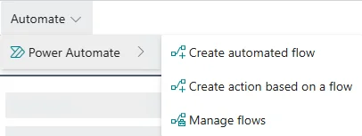

    Is anyone else having an issue with new users in BC v27 not seeing their assigned power automate flows?

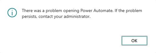

    I have two new users, with permissions assign via Security Group and Power Automate flows assigned via Security Group, who cannot see their assigned power automate flows. When those users interact with Automate > Power Automate, they either receive and error or no message at all.
    Something additional, the company badge and company switcher are also missing for these 2 users. I did assign super permissions to one of the users as well as assigning a new Power Automate Flow directly to the user with no luck.
    Edit: both users can sign in make.powerautomate.com and see their flows there

    Update:
    On Monday (3/2) the Assigned Power Automate Flows suddenly showed up and the user was able to run all the flows assigned to them.
    As for the Company issue, I stumbled across and older post in another community where they had to change the assigned company and change it back. My environment only has 1 company, I added one to our Sandbox, then changed the company in User Settings, had the user login to the sandbox, then cleared their session, then put the company back and had them login again. At that point they could see the Company Badge and the Company chooser showed the Sandbox, in a few hours the rest of the companies and environments showed up. Given I only made this change in 1 Environment, odds are pretty good the issue just resolved itself and my changes where coincidental.
