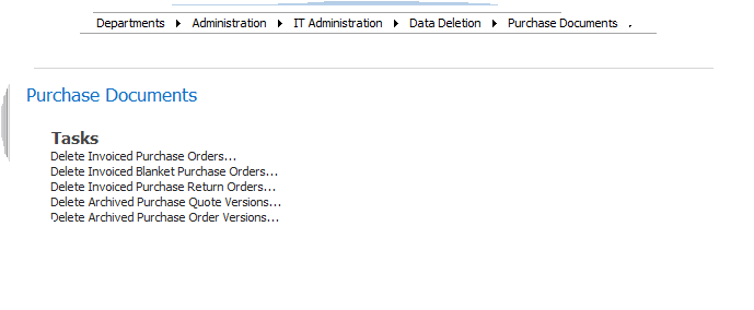

      December 8, 2016 at 11:15 AM
      If the “stale” purchase orders have been fully received and invoiced, you can use the Delete Invoiced Purchase Orders routine on the Administration > IT Administration> Data Deletion > Purchase Documents menu.
