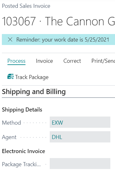

    • Steven Chinsky
      June 4, 2021 at 5:17 PM
      Devora,
      I think you are stating the field Package Tracking is not shown on the Posted Sales Invoice screen and worse, not editable. Very True but you could ask your Partner to make this field Editable.
      Steve
