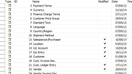

      I would imagine Cronus Demo database will be a good starting point, and depending on which versions of Cummulative Updates (CU) you have applied – they won’t be considered custom modifications as well.
      Then if you go to Microsoft Dynamics NAV Development Environment, you can consider objects that were marked “Modified” (not always the case) as having custom modifications.
      Comparing your production database and demo database, including CUs, in object text files should throw you the differences (areas you have modified).
