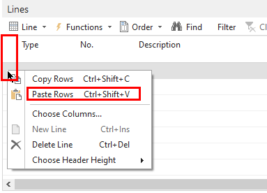

      Yes you can copy and paste into Sales Order.Ā  NAV2015 can be a bit finicky with this and you’ll need to keep trying until you find the precise movements that work for you.Ā  My users do it all the time with other pages in NAV.
      Here are the steps I would perform.
      1. Adjust Sales Order page to show Type, No., Quantity.
      a. You can have additional columns after Quantity, but not in between.
      b. Best to hide Description and not move it to after Quantity.
      i. NAV will want to auto populate No. so moving it or making it blank will probably clear out the Description.
      2. When you receive the Excel sheet, add Type at the beginning.
      a. Enter “Item” into the new column and copy all the way down.
      3. Copy cell A2 (assuming you have a header row) down to cell C101.
      4. In the left margin of Sales Order lines,
      a. Right click and choose Paste Rows
      b. This is the step where you would need to test until you get it right.

    • Kevin Brennan
      September 29, 2021 at 9:19 AM
      Hi Jimmy,
      This is working exactly as you’ve described below.
      We have a 3 column template (item item item item – worked) that is working.Ā Ā
      I really like this option – once we nail down the template, multiple Customer Service folks can use it via the front end.Ā Ā
      If there are issues (with our template, or our process), the front end of NAV will hopefully prevent us from “garbage in.”
