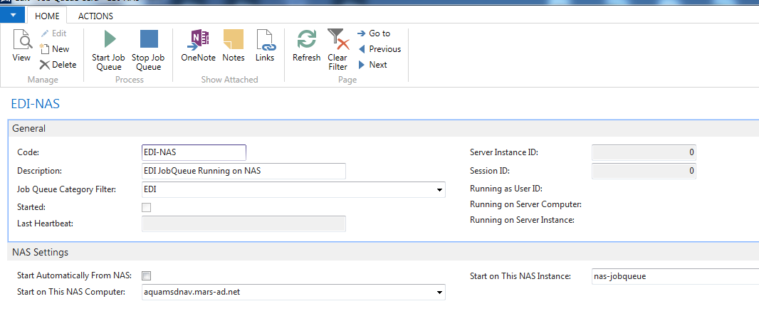

      After running job queue tasks manually for the last few years, I decided to set up a new NAV instance to be used as a NAS.Ā  I changed my Lanham EDI tasks to run on the Job Queue using the NAS and nowĀ  we are receiving multiple copies of sales orders received.
      Any thoughts?Ā

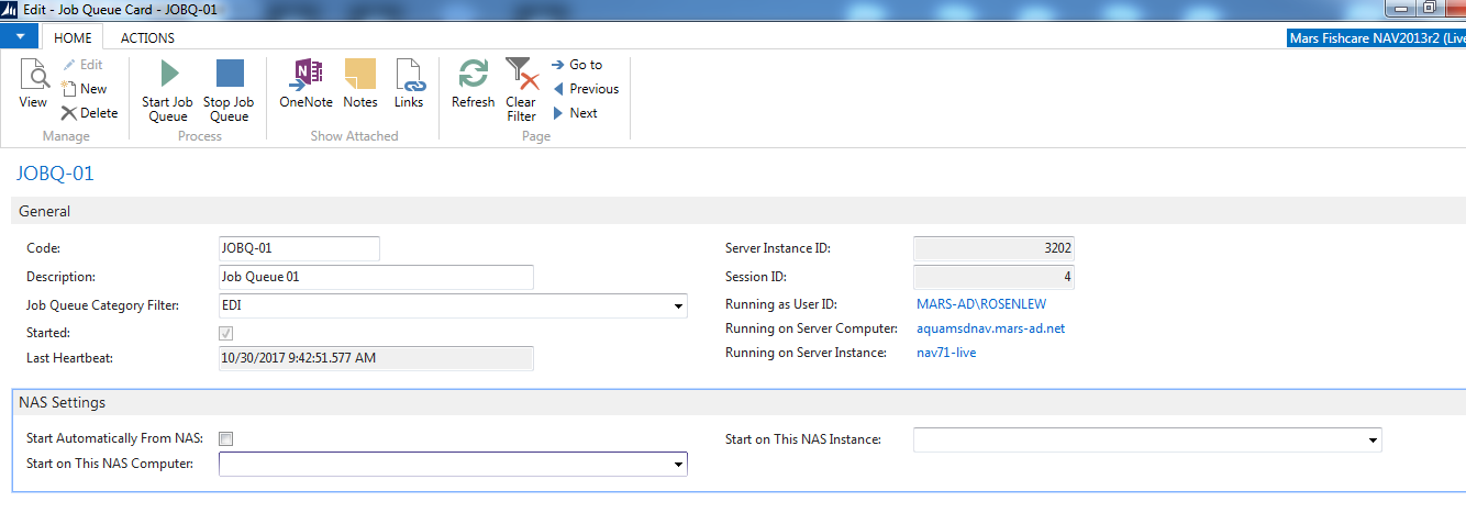

      ?The incoming EDI 850 files should clear from the inbox folder and into the inboxarchive folder as they are converted.Ā  There were no pop-ups to answer, etc. with the previous setup.Ā Ā  Previously, it ran on a job queue that I had to manually start at the beginning of each week.Ā  Now it is running on the NAS.
      OLD SETUP:Ā  I would just click Start Job Queue at the beginning of each week:
      NEW SETUP –Ā  Job Queue runs on a NAS – I just check the “Start Automatically from NAS” checkbox andĀ never touch it again.
