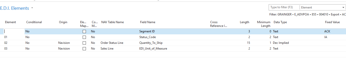

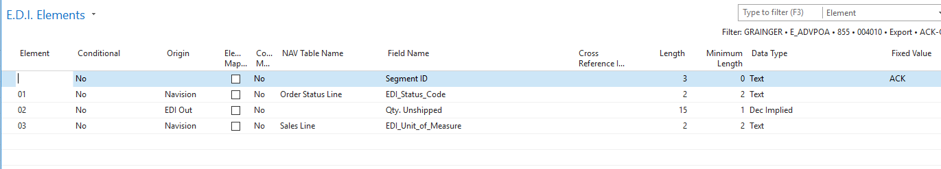

    • Justin Falconer
      January 26, 2018 at 11:30 AM
      ?We have done this by Mapping a Default ACK, and then the Code and Qty on the POA is for the Backorder Amount
      This is the Default IA ACK Segment, I have this set to Skip if Qty to Ship is 0
      ACK IAThis is the Other ACK Segment, this is set to skip if Qty Unshipped is 0
      ACK Other
      We are using the Advance POA Document.

      January 26, 2018 at 4:12 PM
      ?Thanks, Justin!
      That was a great help!Ā
      I assume that theĀ EDI OUT value for Quantity.Unshipped is updated after a shipment is posted.

    • Justin Falconer
      January 26, 2018 at 4:58 PM
      ?I’m not sure what release Lanham added this EDI Out in but the description shows “EDI Orig. Qty. – (QTS + Qty Shipped)”
      We are on NAV 2016 with EDI SE0.60.12

    • Naveen Jain
      January 30, 2018 at 1:25 PM
      Justin,
      What Lewis suggested is a custom built EDIOut. This requires you to change the codeunit to add this custom EDIOut.
      EDIOuts are the kind of formula fields you can create by writing your on code using your developer license assuming you have one otherwise you would need to request your VAR or NAV consultant to make that change for you.
