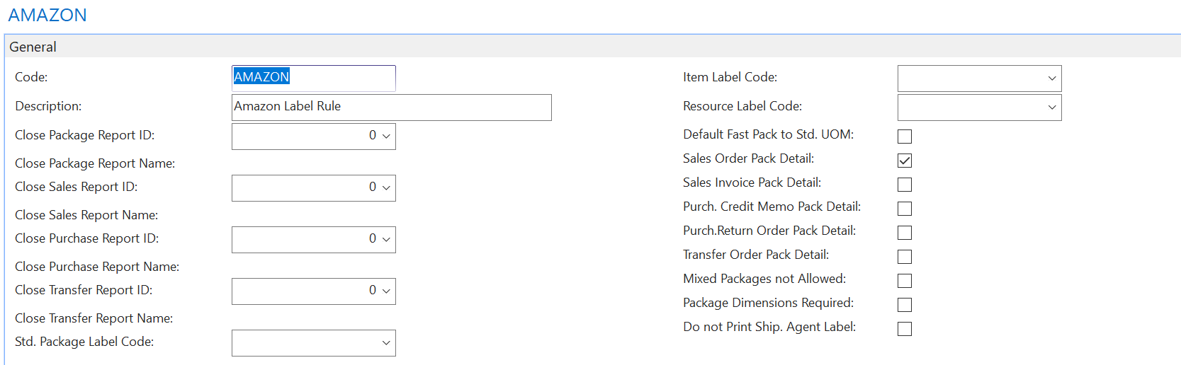

    • Justin Falconer
      January 21, 2020 at 10:37 AM
      Can you post a screen print of your packing rule?

      January 21, 2020 at 10:45 AM

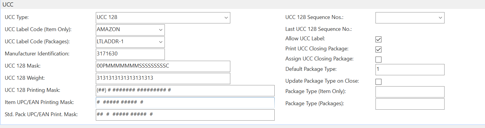

      Not sure if this is causing it but on the UCC Tab, the Field “UCC 128 Sequence Nos” has a Number Series Linked to it in our system
      On the UCC Tab I also have the Option “Assign UCC Closing Package” Checked
      I also have on the “ASN” Tab “ASN Requires UCC No.” is checked

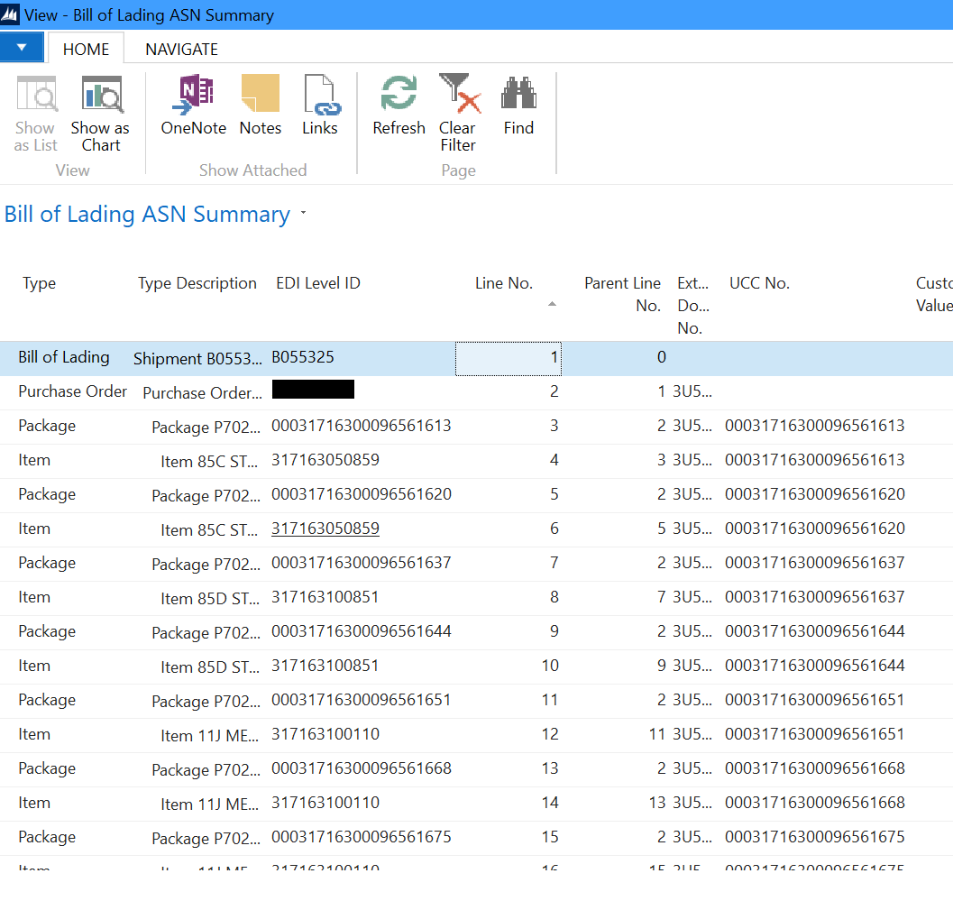

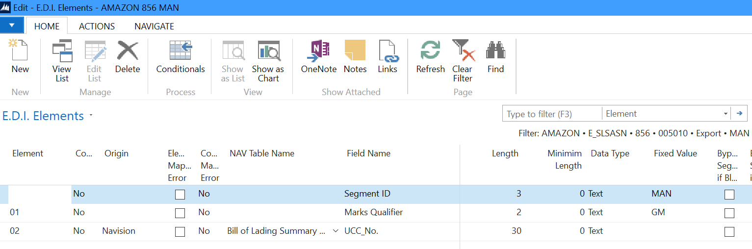

    • Charlotte Kinney
      January 21, 2020 at 12:46 PM
      Lewis,
      Go to the Bill of Lading in question, select Navigate in the ribbon >> ASN Summary.Ā  Do a “Show Column” for the ‘UCC No.’ and send a screen shot.Ā  I am assuming the 856 mapping of the UCC #Ā ?is coming from the “Bill of Lading Summary Line” ‘UCC_No.’ field.Ā  If so, the BOLs ASN Summary page is where the values come from.Ā  Let me know if it is mapped otherwise (but the BOL Summary Line table is the suggested way of mapping).

      January 21, 2020 at 1:28 PM
      Map:
      ASN Summary:

    • Justin Falconer
      January 21, 2020 at 2:15 PM
      Looks like it was all packed in one box.Ā  We ship Cases also and we treat each Case as Its own package in Eship.

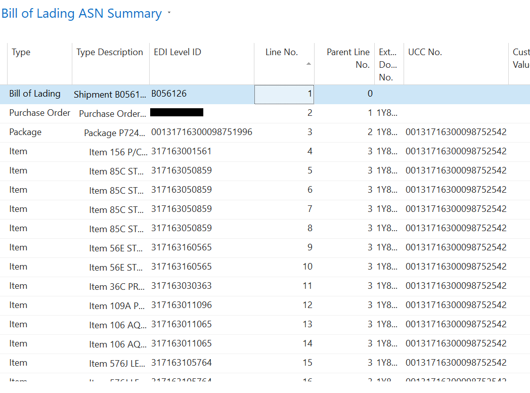

      January 21, 2020 at 2:38 PM
      Interesting….I just tested with the same customer, different ship-to (but it uses the same packing rule) and this looks correct:
      So, I think that there is a process issue somewhere.

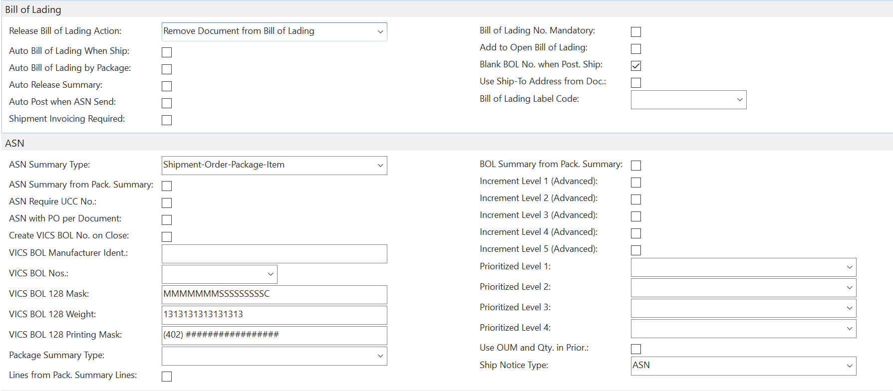

    • Charlotte Kinney
      January 22, 2020 at 4:50 PM
      Lewis…yes, this appears to be an issue with the way in which the order was packed using E-Ship.Ā  It seems like the Trade Partner does not require the TARE (pallet) level.Ā  I say this because the Packing Rule’s “ASN Summary Type” = Ship>Order>Pack>Item (no TARE represented).Ā  If that is the case, then the easiest solution is to NOT pack the tare (ie, do not run the //AAP (Add All Packages) command).Ā  I have attachedĀ  2 screen shots taken from the BOL >> ASN Summary to show the hierarchical level build based on the Packing Rule’s ASN Summary Type.Ā  As you can see the BOL Summary where the tare/pallet was not packed is correct in that each package reflects it’s unique UCC/GS-128 ID.Ā  The BOL Summary where the tare/pallet was packed you’ll notice that the items have now inherited the pallets UCC/GS-128 number.Ā  This is what I believe you experienced in the initial screen shot of the problematic ASN.Ā Ā

      Here is what I recommend assuming the Packing Rule is updated based on the above:
      (1) Create Whse Ship
      (2) Create Whse Pick
      (3) Register the Whse Pick
      (4) Open Pack Line Scanning page – Scan in the Sales Order No.
      Ā  Ā  Ā (a)Ā  Scan //CSPPĀ  (Create Standard Pack Print)
      Ā  Ā  Ā (b)Ā  Scan //PR (Pack Remaining) and //CPP (Close Package Print), when necessary
      Ā  Ā  Ā (c)Ā  Scan //CO (Close Order) which post the Shipment/Whse Shipment (assuming the Packing Station >> Label & Posting fast tab >> Sales Order Close Action = Ship)
      If you wanted to get fancy, you could create a custom barcode that runs steps A-C all in 1 step/barcode using the “Standard Option Setups” but I won’t get into that because I don’t want to change up processes too much.Ā  On the other hand, this would prevent the shipper from accidentally running the //AAP command which creates the tare.Ā  So just some things to think about.
      Using the steps above, the BOL would auto create and release.Ā  The BOLs “ASN Summary” is based on the attached “Correct” screen shot.Ā  Each carton pack will have it’s own unique UCC/GS-128 ID.Ā  Hopefully this will work out but if the Trade Partner requires the TARE, let me know and I will send updated information.Ā  I hope this helps you out as well as makes sense what is happening with the inherited UCC/GS-128 numbers for the individual cartons when the tare is packed but not reflected in the ASN Summary Type (as well as Stuart!).

      Wow Charlotte!Ā  Ā This is a great help!Ā  I also want to thank you and everyone at Lanham for adding the hover-over-field documentation that I see in Business Central v13.Ā  We don’t currently have that available in NAV2013R2.
      I discovered why //BOL “did not work.”Ā  It was actually working sort of…it created the BOL, but did not pop-it open and link to the order.Ā  I found that some of our packing rules hadĀ BOL Summary from Pack Summary checked and some did not.Ā  It is now checked for all packing stations.
      We also learned today that if you START the Pack Line process with //BOL, it will link the BOL to the order and later when the shipment is posted, it automatically links the posted shipment to the BOL (on the BOL Worksheet).Ā  Our Shipping team tried using //BOL after posting the shipment but still had to ADD THE POSTED SHIPMENT.
      Creating a “custom bar code” is a great idea and something we have considered, but we’ll wait until we really understand and iron out the process.Ā  I will now review to see which (if any) of out trading partners currently require the TARE.Ā  I think we have some.
      I’m still trying to understand theĀ Default Package Type fieldĀ  on the UCC tab.Ā  We have it set to “1” for most Trading Partners, but it is “0” for a couple.Ā

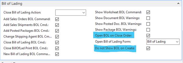

      January 31, 2020 at 1:37 PM
      <<I discovered why //BOL “did not work.”Ā  It was actually working sort of…it created the BOL, but did not pop-it open and link to the order.Ā  I found that some of our packing rules hadĀ BOL Summary from Pack SummaryĀ checked and some did not.Ā  It is now checked for all packing stations.>>
      OK, so that setting is not what makes the BOL open from Pack Line Scanning.Ā  It creates the Bill Of Lading, but does not force it to open.
      For some of our customers, the BOL is created and opened when we use the //BOL command.Ā  For others, it creates the BOL, but it does not open it.
      Does anyone know why?

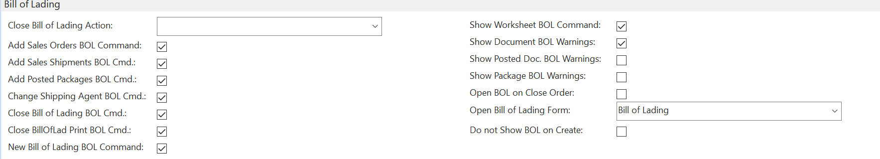

    • Stuart Ness
      February 3, 2020 at 10:17 AM
      The only place that I have had affect whether the BOL opens when closing an order has been on the packing station setup. (Not to say there couldn’t be something else out there – but we didn’t need to modify it.)
      In the Packing station, we have it set up to open the BOL when we close the order, not on create of the BOL, but it is two options that we have manipulated:
      Packing Rule - Bill of Lading, Open BOL on Close Order and Do not show BOL on create are checked so the BOL opens when we close the shipment.

      February 3, 2020 at 5:32 PM
      Interesting.
      All of out packing stations are set up like this:
