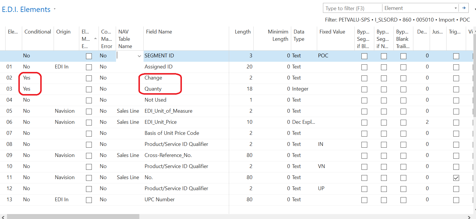

      August 6, 2020 at 9:30 PM
      HI ,
      My Delete Item works, but the replace RZ is not working.
      Here’s the POC segment map:
      POC

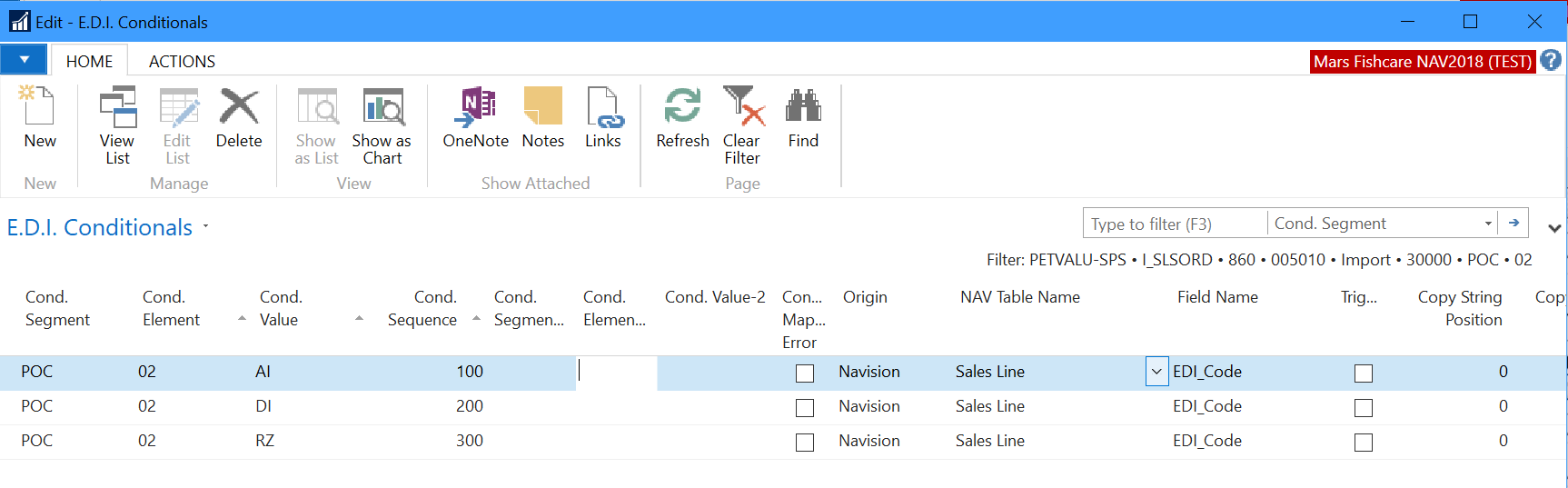

      …and the POC-02 conditionals:
      POC-03
      ??…and the POC-03 conditionals:

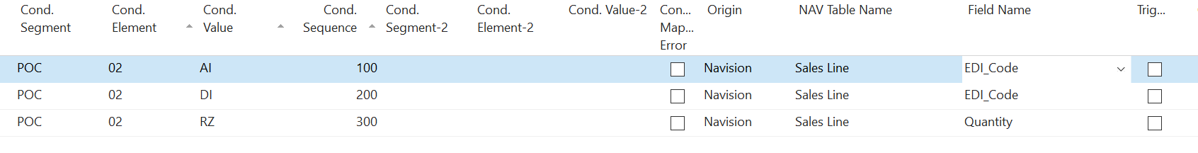

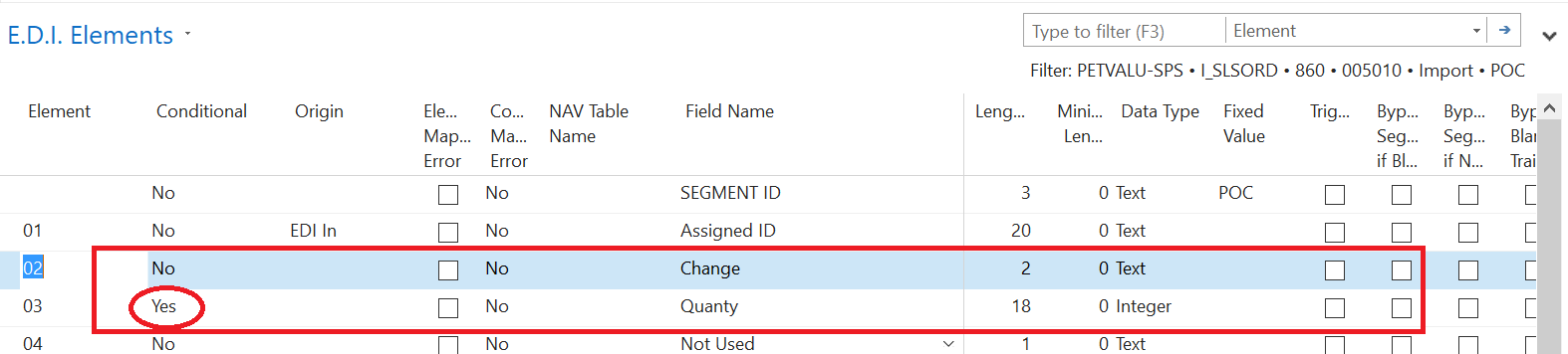

      I finally worked this out.
      The Trading Partner is sending the CHANGE CODE in the POC-02 and the QUANITY in the POC-03.Ā  They are not using the POC-04.
      All of the conditionals belong in the POC-03 and no conditionals are used in the POC-02.
      For Add Item (AI) and Delete Item (DI), the POC-03 is mapped to Sales Line, EDI_Code.
      For Change (RZ) it is mapped to Sales Line, Quantity.
      POC:
      POC-003 Conditionals:
