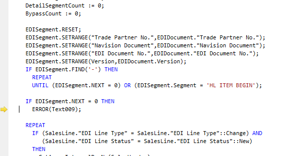

      I feel like I am close to figuring out how to process an EDI855 using Lanham EDI (version SE0.60?) on NAV2013R2.Ā
      When I run Send & Advance PO Acknowledgement (Report 14050321) from the Advanced PO Acknowledgment Card (P14002414), I get an error (in CodeUnit 14002400 – E.D.I. Sales Order Status Send).Ā  The error is “No Item Segments Found.”
      When I look at the code, it seems like it is looking for an HL ITEM BEGIN segment in the map,Ā  but the EDI855 doesn’t include any HL segments.
      Has anyone seen this before?

      For the Advanced PO Ack, you need an HL ITEM BEGIN and HL END Commands in the map.Ā  See attached sample map.
      There is also standard PO Ack that uses LINE BEGIN and LINE END Commands.Ā  The code you are running is for the Advanced though.

      I don’t understand why this is either, but there are 2 solutions.
      1. Use the HL commands, but don’t put any HL segments in the map.
      2. Modify the codeunit to add LINE BEGIN/END as an option.
      UNTIL (EDISegment.NEXT = 0) OR (EDISegment.Segment IN [‘HL ITEM BEGIN’,’LINE BEGIN’]);
      IF (EDISegment2.NEXT = 0) OR (EDISegment2.Segment IN [‘HL END’,’LINE END’]) THEN BEGIN

      I was usingĀ  a LINE BEGIN and LINE END instead of the HL ITEM BEGIN and HL END.

      ?Hi, Lewis- The map should use HL Item Begin and HL End commands, but I have also seen this error if you don’t have anything set in the Qty To Ship field. If Qty to Ship is 0 it won’t find the line.
