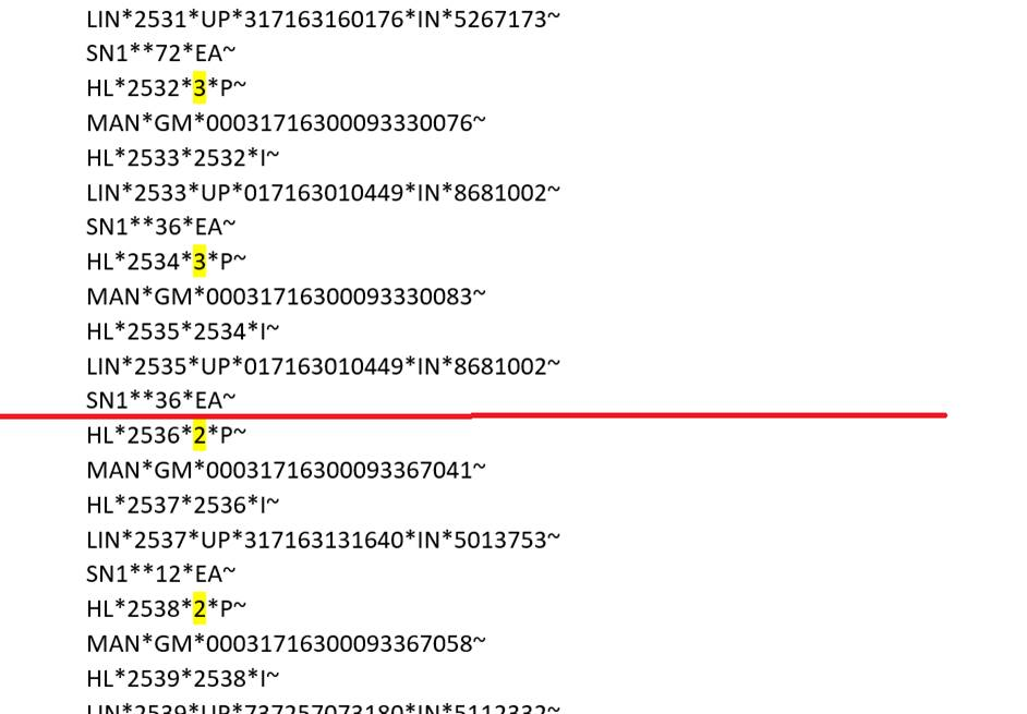

      ??Hello,
      We’re on NAV2013R2 with Lanham e-Ship and Lanham EDI.
      We have a trading partner reporting erros back on SOME of our ASNs that we send them becuase the HL-02 PACKĀ segment contains a value of 2 instead of 3 on SOME on the HL-PACK segments.Ā  The EDI packing Rule is S-O-T-P-I and we are including a TARE segment.

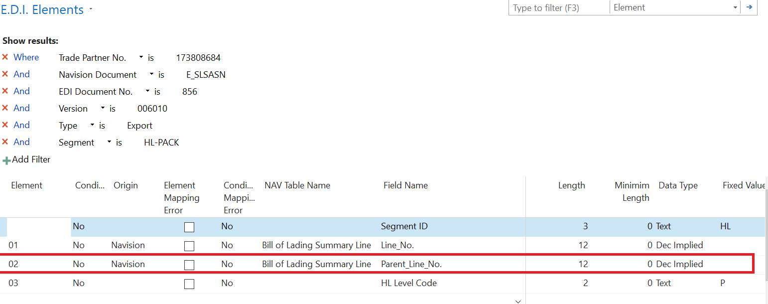

      The HL-PACK segment map looks like this:
      EDI map HL-PACK
      In the data, for the HL-Pack segment, the HL-02 (parent line number)Ā sometimes changes from a value or 3 to 2.Ā
      The question is, what process would change that value?Ā  I suspect that it is something we are doing in the Pack Line Scan process.
      Example of the data:
      ASN data

      I am pretty sure those packages with HL*2*P~ were not added to the tare pack. The ‘2’ in the HL-02 represents the ORDER level.
      What you can do is go to this Bill of Lading and in the ribbon select Navigate >> ASN Summary.Ā  If the “Line No” and “Parent Line No” are shown, this is where the map is getting it’s values from.Ā  Find the erroneous package where the Line No. = 2536. Double-click on the Description of “Package xxx” to open the package page.Ā  While on the header of the package, Zoom (Ctrl+Alt+F1) and expand the ‘Table Fields’ fast tab.Ā  Scroll down to “Used on Bill of Lading No.”Ā  I am assuming this value is blank.Ā  The “Used on BOL” field is populated with the tare package of which the carton package is placed within.Ā  If this package was not placed in a tare-pack, then it is viewed as a standalone package thereby it’s parent would be the ORDER level.Ā  I hope this makes sense and clarifies the issue.
