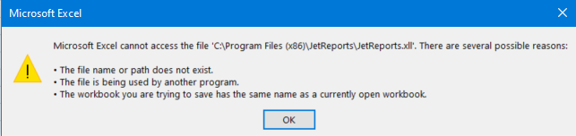

      A user had Excel crash and since then Jet Reports does not work.Ā  We have tried running the repair and also uninstalling and reinstalling.
      The Jet tab does not show up in Excel.Ā  When we try to go to Options in Excel to enable the add-in, we get the error message:Ā  Microsoft Excel cannot access the file ‘C:Program Files (x86)JetReportsJetReports.xll’.Ā  (The file does exist)Ā

      I haven’t had that particular problem, but have seen a few other problematic installations.Ā  One thing that has worked for me is to copy the program folder over from another machine into the problem machine.

      Thanks.Ā  That is a good suggestion, but corporate has policies in place that prevent us from installing from unapproved folders, so we may get blocked.

      This was resolved with a repair of MS Office.
