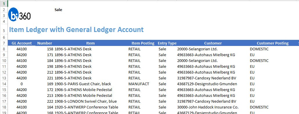

      Here is a White Paper on how to add the GL Account to the Item Ledger Entry for reporting.
      Item Ledger Entry with GL Account – Solver Forums
      Nav Item Ledger
