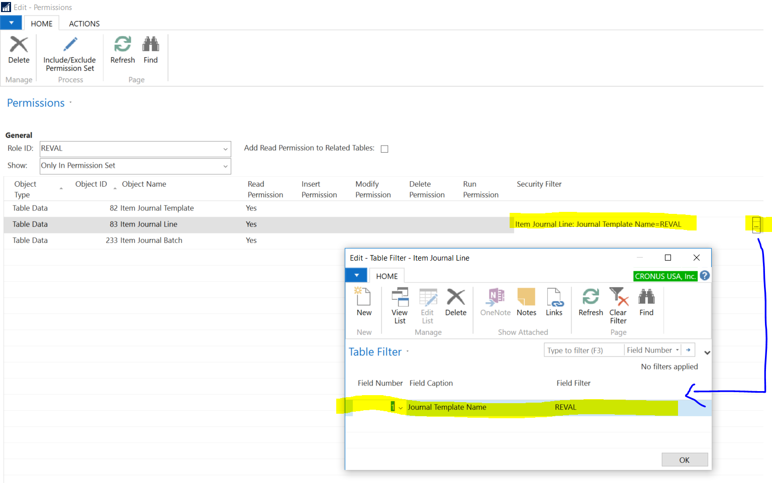

      I don’t have access to a NAV 2009 environment right this moment, so I’ve taken a screenshot in NAV 2017 (below).
      I created a “Permission Set” (in NAV 2009 it may still have been called “Role”, which you can get to from Tools > Security in the Classic Client) called REVAL, and added the following permissions to it. You may want to add more, but you will at least need the three lines I have in the screenshot. Notice that I’ve the Object Type to ‘Table Data’, and not to Table. And for Table Data 83 (Item Journal Line), I’ve set a Security filter to enforce this only on the Revaluation Journal (by default, it is called “REVAL”; your NAV may use a different name; you can verify this by going to the Item Journal Template form/page, and finding the NAME for the record that has Type set to Revaluation). I could have used the = sign in my Security filter, but it will work just fine without it as well.
      When done, assign the Role / Permission Set to the desired User(s). You’ll want to make sure they have permissions to do basic activities in NAV (by using an out-of-the-box Role called ALL for Classic Client, or BASIC for the Role Tailored Client; or your organization may have one of its own. Without it, they won’t get very far at all in NAV.. forget modifying data in the Revaluation Journal, they wouldn’t even be able to get to the Revaluation Journal to begin with).
      In NAV 2009, the user(s) will need to exit NAV and log back in after you’ve assigned new permissions to them. Keep reading below the screenshot – it’s like fine-print: boring, but important information…

      Also, consider what other Roles/Permission Sets you have assigned to the user. If one Role/Permission Set assigned to a user allows them to Insert, Modify, or Delete data for a certain Object Type (such as Table Date 83 – Item Journal Line), this will take precedence in NAV over any other Role/Permission Set where you restrict a user inserting, modifying, and/or deleting data for the same. Also, assigning permissions to Object ID 0 for any Object Type (such as Table Data 0, Page 0, etc.) will result in blanket permission for data in all Tables, all pages, etc.
      Regarding Security Filters in NAV Permissions, you can use operators like = < > etc. but * and ? type wildcards will not work. So you could have set the field filter in the screenshot to REVAL, =REVAL, or <>REVAL, etc. but not RE* or RE?AL.
