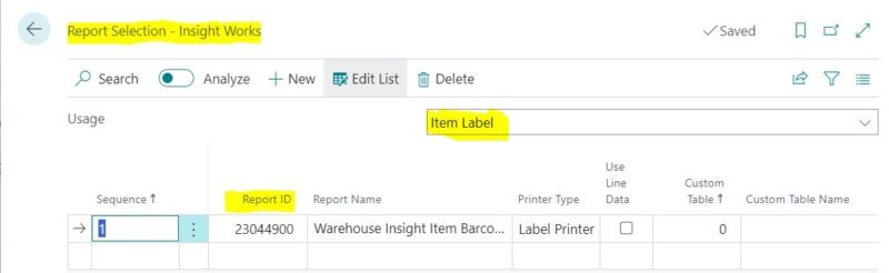

    We use Warehouse Insight and have the report ID 23044801 “Generic Item Barcode Label” selected in the Report Selection – Insight Works list

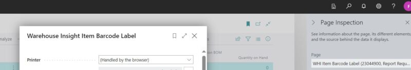

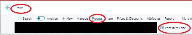

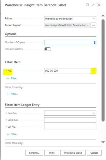

    We use Insight Works too and when I go to the item list and select Process –>Print Item Label, I get this pop-up that shows that it is the Warehouse Insight Item Barcode Label. I included how we have this report selection setup in Insight Works Report Selection. (We use a different report number).

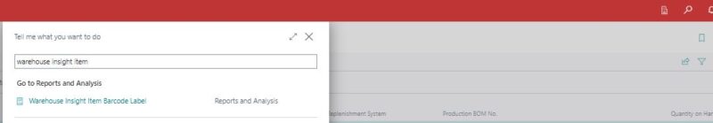

    If I print the label from the open Item Card, then I get the same GTIN label as yourself. However, if I am in the item list and then select Process, Print Item Label the popup for the Warehouse Insight Item Barcode Label appears and from here I can select my Item No.
    Also, you can global search for Warehouse Insight Item Barcode Label and you can select your item no. from here too.
