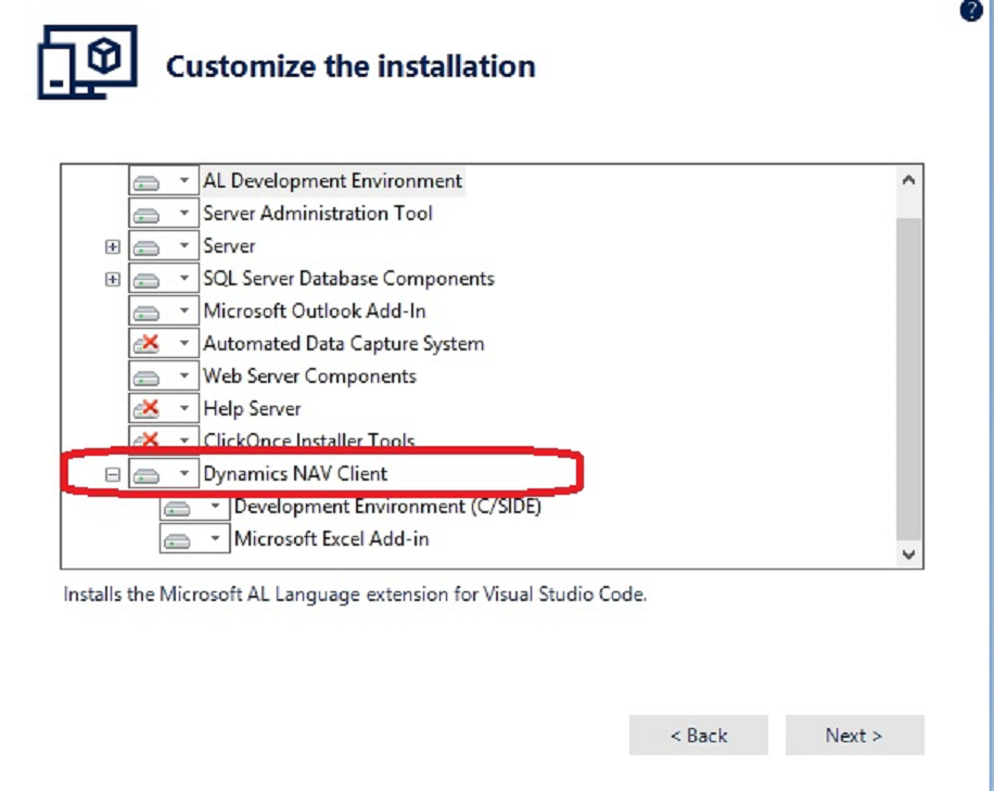

      Hello Everyone,
      I just downloaded and installed the Cronus Demo Database of #D365BusinessCentral On-Premise on a spare laptop.Ā  The web client has been installed, but I am hoping to install/set up the Windows Client.
      Is there any trick to doing that?Ā  Below is an image of my selection that enable the web client.
      BC Install
      My next question:Ā  Is it safe to install the BC Demo Database on my work laptop where I already have a production copy of NAV2013R2 running and a NAV2018 Cronus database running.Ā  It appears that this will not be an issue, but I would like some assurance since I have some test data that I do not wish to lose or corrupt in my NAV2018 playground.

      I have the BC client installed, I first selected the option to install a demo which only gives you the web client and then re-ran the install and added the windows client.Ā  I had no issues with doing this.
      I’m also running 3 versions on my laptop.Ā  I have 2016, 2017 & BC.Ā  So far I have not had any issues apart from conflicting port numbers which I’m sure you know how to resolve.

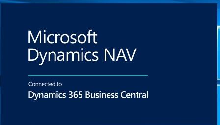

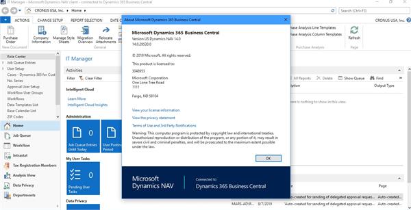

      August 13, 2019 at 2:41 PM
      Thanks .Ā  The client was there as you pointed out and when you load it, it reads “Microsoft Dynamics NAV Connected to Dynamics 365 Business Central.”
      NAV-BC Client
      The client looks more like NAV2018 than the BC Web (Modern) Client.
      BC Windows Client
