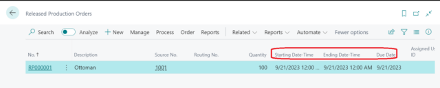

    On a related note, I also don’t see an option to add due date. Another helpful Production order management field. Again, is this something that is there but I’m missing it?
    December 18, 2023 at 4:03 pm
    Hello Blaine,
    I see start date/time, end date/time, and due date in my BC22 playground, and I know we have the fields in BC14 and earlier versions of NAV.

      Thanks. The other field that would be nice is expected number of hours. For example, I can get that information in the production order under Statistics, but would be nice to have as a field possibility in the list of production orders. Is this a field that I am missing for that list?
