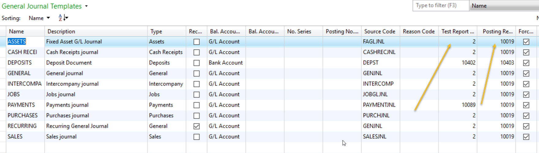

      I can print from Navision almost anything but now when I am in the general journal I request post and print and it post the entry but doesn’t print the journal register. Does anybody have any suggestions?

      Hi Roland, do you have the report setup for general journal printing in the reportĀ selection? It shouldĀ print with theĀ post and print.

      Where can i find that function to check it?

      Go to the General Journal Template and choose columns Test Report ID and Posting Report ID and enter the desired report if it’s not there.
