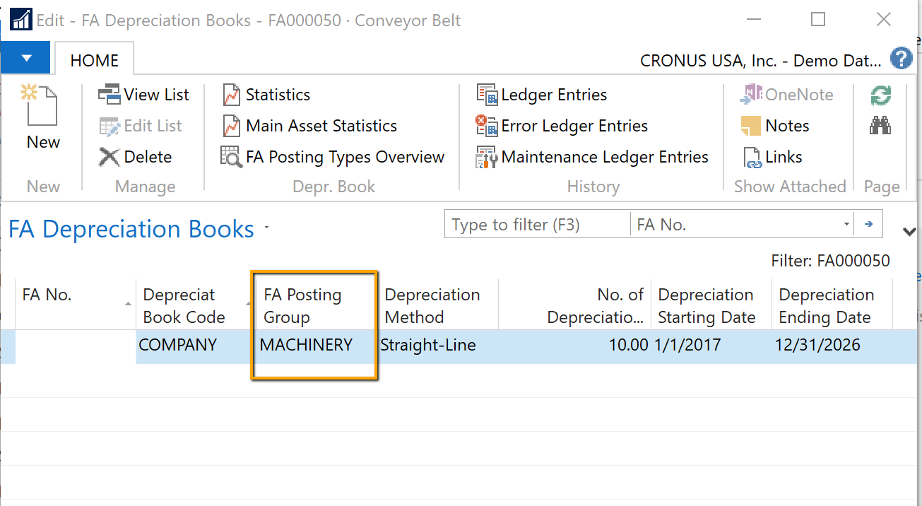

      Where do you correct the FA Posting Group for a particular Asset?

      Roland,
      It is on the FA Depreciation Book record found through the Fixed Asset Card.
      FA Dep Book
