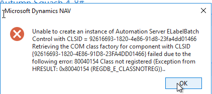

      Park 100 Foods is going live next week and have stumbled into an issue.
      We have always used EZ Label to create labels being output from NAV but we are getting a nasty error that seems to have everyone with our ERP team puzzled.
      Does anyone use EZ Label with NAV 2018?
      Have any of you ever seen a message like this and does anyone have a remedy?
      Any and all help will be greatly appreciated.

      HI Bill!
      Here is some insight from our development team:
      NAV 2018 does not support automation servers when code is run at the service tier. Which is where is always runs by default unless told otherwise. You need to use .NET with NAV 2018. Unless you design your code to run on the client. Then there is still some support for automation.Ā
      If you do have the code running at the client, then likely the automation server is not registered.
