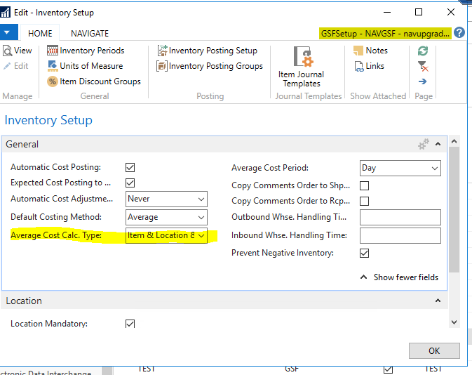

      If you do go the variant route, I would also suggest keying your direct ship PO/SOĀ into a separate location code. That way you could segregate your costs as well. Also in inventory setup, change your average cost calc. type to “Item & Location & Variant”.
