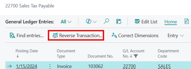

    What not just use the Reverse Transaction from the general ledger entries screen?

      Hi Kim, I’m not looking to Reverse the transaction. I’m looking to copy the entry and do it again, potentially with a different amount and/or date.
