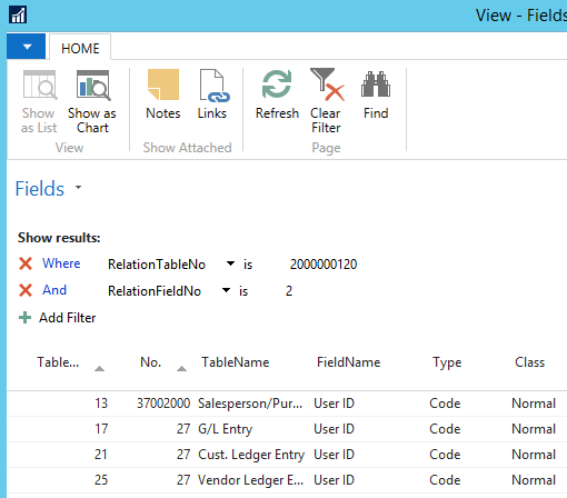

    • Jason Wilder
      January 16, 2018 at 1:44 PM
      Per your request here is what I did to make the name rename doable in a reasonable time.Ā  Run Page or Form 7702 (Fields) and set the following filters to see what tables are related to the User table field #2 User Name.Ā  This will list all of the tables that will be impacted by renaming the User Name:
      ?We had 148 tables many of which we didn’t use.Ā
      So the next step is to see how many records exist in each table.Ā  I grabbed the record count from the Database Information Form in classic client but you could grab directly from sql or write some code to get it for you.
      Then you have to decide which tables you want to update.Ā  For example our G/L had 100 million records (not exaggerating)Ā  so there is just no way we could update this table in a reasonable time frame.Ā  These are the tables I skipped:
      TableNo TableName
      17 G/L Entry
      21 Cust. Ledger Entry
      25 Vendor Ledger Entry
      45 G/L Register
      46 Item Register
      96 G/L Budget Entry
      254 VAT Entry
      339 Item Application Entry
      379 Detailed Cust. Ledg. Entry
      380 Detailed Vendor Ledg. Entry
      405 Change Log Entry
      5802 Value Entry
      Then the final piece is to alter the upgrade toolkit to skip the rename process based on the tables you chose to skip.Ā  I don’t remember the exact function where I did this but if someone had a database with the upgrade toolkit installed I could find it pretty easily.Ā  The code I added was straight forward and something like this:
      IF NOT (Tableno IN [17,21,25,45,46,96,254,339,339,379,380,405,5802]) THEN BEGIN
      So the solution is to basically skip the rename in some of the tables.Ā  You can certainly go back at a later point and do this step when you have more time.Ā  Plus you could do it with commits every 100 records or so, so it shouldn’t lock your users.Ā  I have not gone back to do this and probably never will as I haven’t seen any negative impacts of not doing this.Ā  Don’t forget that the this process is per company so you might be able to rename for all tables in one company but maybe not another based on the number of records in each table.

    • Melissa Reichenbacher
      January 24, 2018 at 11:31 AM
      Hi Jason,
      I am working on this for Kari.Ā  ?It appears that this change needs to be made to codeunit 418.Ā  Does this make sense?
      Minneapolis MN
    • Jason Wilder
      January 25, 2018 at 12:03 PM
      Melissa that does make sense but do you have the codeunit that calls codeuit 418 in the upgrade toolkit?Ā  I think the place you want to limit to certain tables is in the calling codeunit.Ā  You can email me and we could set up a quick GoTo to find the correct spot if you want.
