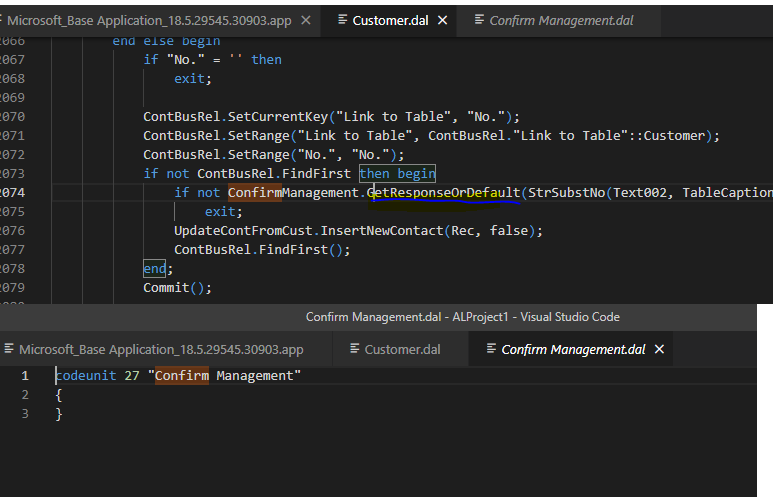

      I was using the function ConfirmProcess from this codeunit and looks it is not available anymore. Is there any article – documentation about this codeunit.
      Also on AL code we can see on Customer table for example have a call to a function GetResponseOrDefault however the definition of the codeunit does not show any function.
      What I am missing? Any help is appreciated.

      CU 27 cannot be opened, the parameter showmycode in the app.json is set to false.
      procedure GetResponseOrDefault(ConfirmQuestion: Text, DefaultButton: Boolean): Boolean
      Raises a confirm dialog with a question and the default response on which the cursor is shown. If UI is not allowed, the default response is returned.
