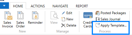

      A business user posed the question… is it possible to use a Configuration Template on a Ship-To-Address? I am thinking not because there is no Apply Template button on the Ship-To card, but I figured I would ask. I see the Configuration Template allows me to create it for any table in the database.

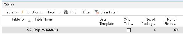

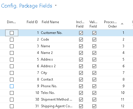

      You should be able to use a configuration package to load ShipTo info if that helps. Shipto is stored in table 222 per screen shots below. I hope this helps and let me know if you need any further assistance.

      It doesn’t look like this is possible out of the box, but one of your developers might be able to copy the Apply Template… code/button/function from the Customer Card (Page 21) and add it to the Ship-to Address List (Page 301) page.
      If they’re able to do that, it should give you what your end-user is wanting.
