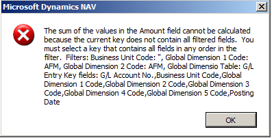

      I am trying to close the 2016 income statement and I am getting this error.  I’m running NAV 2009 R2.  Any ideas?

      Julie,
      This is a found noted NAV error which has been written up on MSDN as a known error; please find the following the write up and resolution.
      Symptom
      “The sum of the values in the Amount field cannot be calculated because the current key does not contain all the fields being filtered. You must select a key that contains all the fields in the filter.”
      This problem occurs in the following versions of Microsoft Dynamics NAV:
      • Microsoft Dynamics NAV 5.0 Service Pack 1
      • Microsoft Dynamics NAV 2009 Service Pack 1 (SP1)
      • Microsoft Dynamics NAV 2009 R2
      Resolution
      A supported hotfix is now available from Microsoft. Speak to your record of VAR or you can contact our office for a service call.

      Check the options you have selected to close your income statement.  Looks like your missing a part of the business in the close process?
