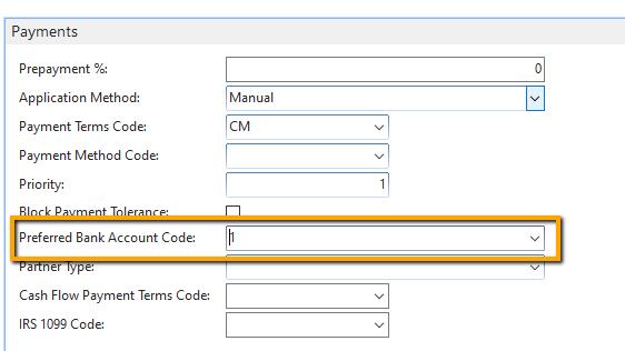

    • Cynthia Priebe
      September 12, 2019 at 9:50 AM
      There is a Preferred Bank Account field on the Vendor Payments FastTab that needs to be filled in. This was not required on older versions. This may be the issue.Ā

    • Liz McQuiston
      September 12, 2019 at 10:05 AM
      Thank you I did see that and fill it in, still getting the error.?
