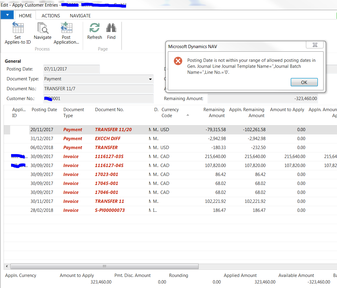

      ?Hello – we should have applied some payments to some invoices but didn’t and I would like to now but I get a message telling me the posting date is not within my range.Ā If I were toĀ  change my allowed posting date so that I can complete the Applied Entries is there any impact to the previous year?Ā Any transactions?
      I am not adding a new invoice or a new payment – just connecting existing transactions.
      Thanks for any answers…

      On Standard Navision you will haveĀ  a GL line with 0 value and (Detailed Customer / Vendor Ledger entries)

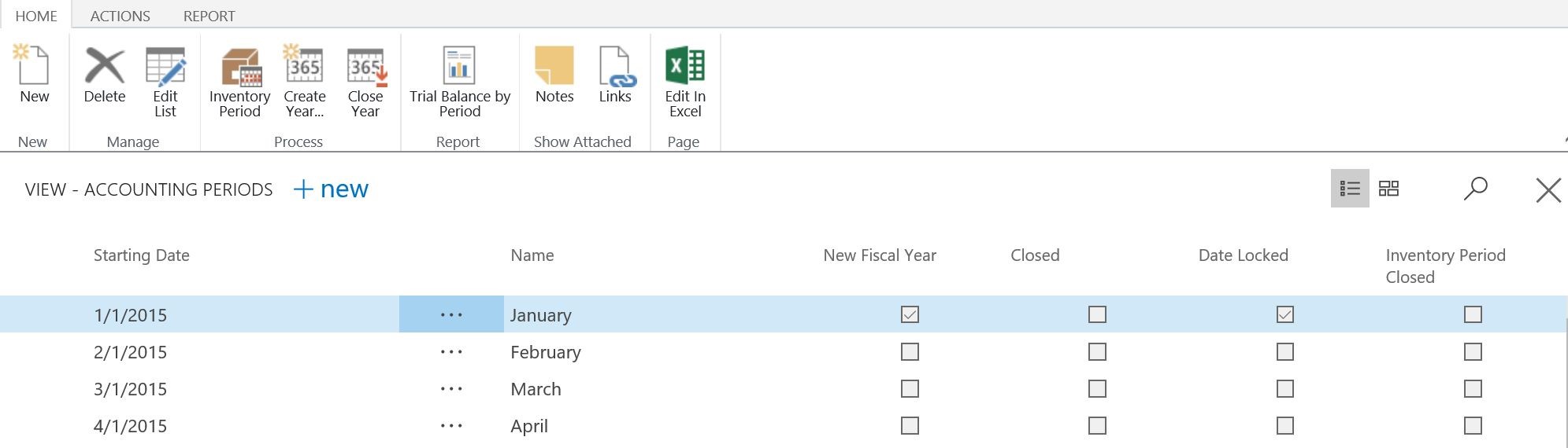

      ?Joe,
      You can go to the upper right hand corner and type in General Ledger set up. Once you are there, you can change the date range so that you can post. Of course you will have to re-close the year.
      Mark
      Mark Walker
      ProSphere
      Alexandria VA
    • Val Gameiro
      March 9, 2018 at 9:39 AM
      Close Periods
      When you close the year, are you closing your Inventory and Accounting Periods?
      I believe NAV will try to post to the current open period, so if you close those prior periods, it’ll try to post the application in the current year/period.
