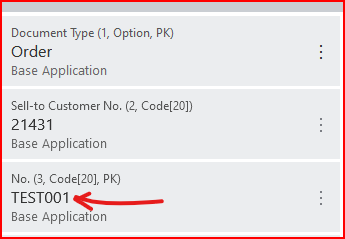

    I do see the header in BC, as confirmed by copy/paste of the document number in the JSON above, and viewing in the page inspector.
