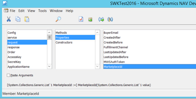

There is a bunch of parameters that you need to set when calling the ListOrdersRequest but the one that I am stuck on is the MarkPlaceID which is required.Ā The thing that makes this parameter a little weird is that it is expecting a List of strings not a text variable.Ā So as you can see below this parameter is expected to be a Dotnet List variable (System.Collections.Generic.List’1).Ā
So I write the code to handle this:
MarketPlaceList := MarketPlaceList.List();
MarketPlaceList.Add(MyMarketPlaceID);

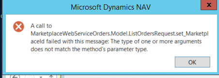

request.MarketplaceId := MarketPlaceList;Everything compiles as it should but I get a runtime error:
This is just plain wrong since it does match.Ā Same code works fine in C# just not NAV.Ā Has anyone encountered this and if so what is your workaround?——————————

?Hello,As a disclaimer I have never worked with MWS but here is my take on your issue:
When creating your List object in NAV you do not specify the type of List (List<string> or List<int>) and that means it will create a List<object>.I am guessing the MarketPlaceId properties of the request is strongly-typed and will expect a List<string>.
My recommendation would be to create a custom add-in that will encapsulate all your interactions with your web service. Then from NAV your call your custom DLL only with simple explicit types like string[] or int[] or decimal.

??Hello Jason,This article confirm whatĀ I was referring to. If you create the list in NAV it will be weakly-typed. However they used another object (x) for which the method GetAStringList returns a strongly-typed List<string> to instantiate aĀ List<string> in NAV.
So IĀ don’t thinkĀ in NAV you can specify the type when using theĀ ListĀ constructor you will have to use another object that will instantiate it for you.
You can create an interop class in Visual Studio with static methods that returns an empty List<string> then call that class to instantiate your object in NAV. It the same as the example for the Array found here https://msdn.microsoft.com/en-us/library/hh167470(v=nav.90).aspx.

Tijane I was about to implement your solution when a colleague (Jack Reynolds, thanks!) pointed me towards a post that answers this issue all within NAV.Ā Here is the article:Ā Ā http://vjeko.com/generics-in-net-interop-for-nav-2013/.
So I have a function in NAV now called InstantiateStringList that creates a List as a string and solves the error I was running into.Ā Here it is:
Local Variables:
ObjectList DotNet System.Collections.Generic.List`1.’mscorlib, Version=2.0.0.0, Culture=neutral, PublicKeyToken=b77a5c561934e089′
Type DotNet System.Type.’mscorlib, Version=2.0.0.0, Culture=neutral, PublicKeyToken=b77a5c561934e089′
Array DotNet System.Array.’mscorlib, Version=4.0.0.0, Culture=neutral, PublicKeyToken=b77a5c561934e089′
String DotNet System.String.’mscorlib, Version=4.0.0.0, Culture=neutral, PublicKeyToken=b77a5c561934e089′
Activator DotNet System.Activator.’mscorlib, Version=4.0.0.0, Culture=neutral, PublicKeyToken=b77a5c561934e089′
Global Variables:
StringList DotNet System.Collections.Generic.List`1.’mscorlib, Version=2.0.0.0, Culture=neutral, PublicKeyToken=b77a5c561934e089′New Function:
// Code below needed to instantiate the list as a System.String instead of System.Object
CLEAR(StringList);
“Array” := “Array”.CreateInstance(GETDOTNETTYPE(Type),1);
“Array”.SetValue(GETDOTNETTYPE(String),0);
Type := GETDOTNETTYPE(StringList);
Type := Type.MakeGenericType(“Array”);
StringList := Activator.CreateInstance(Type);If you come across this post and you are working on Amazon integration please feel free to message me and I will help you out.
