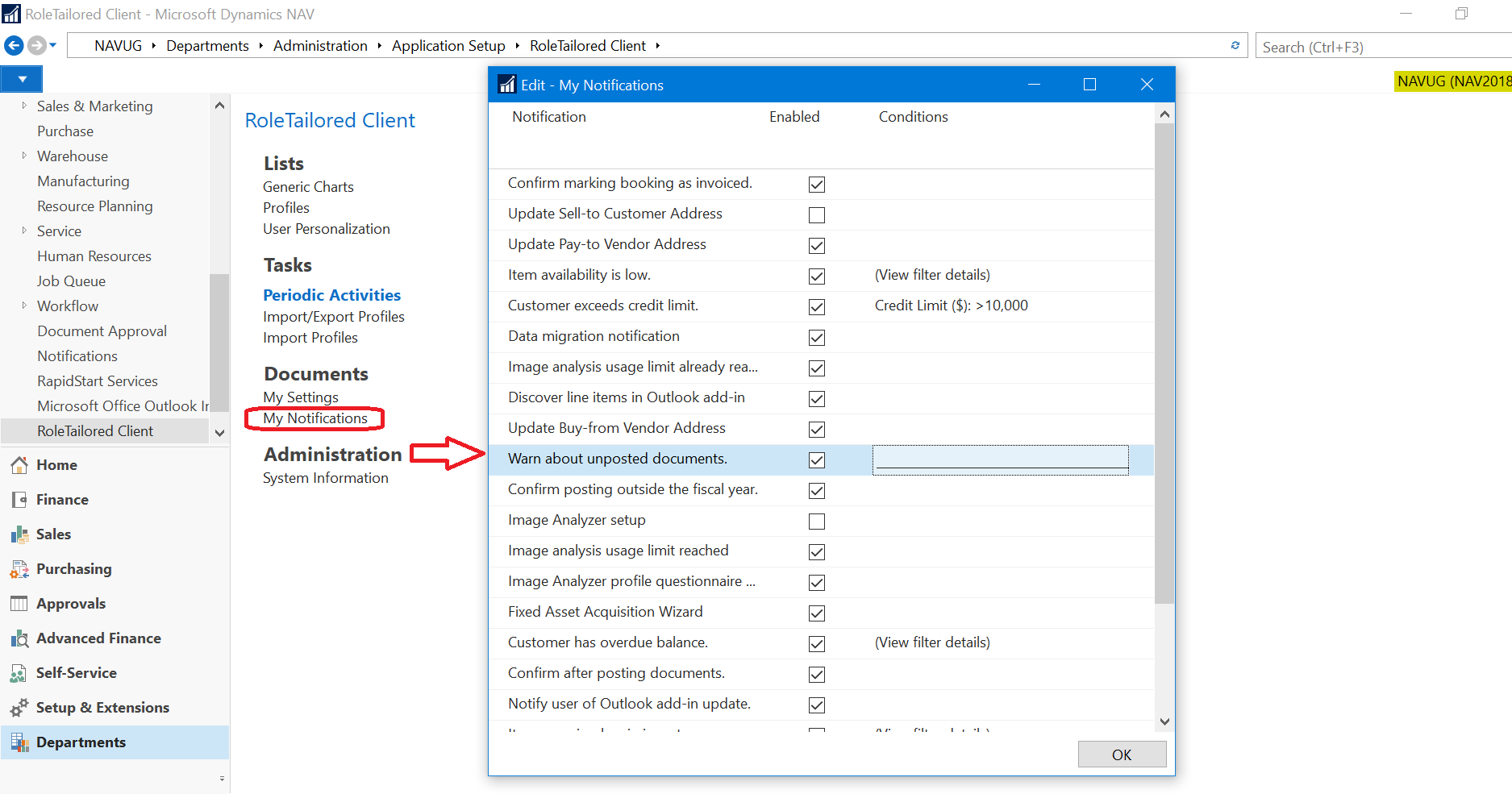

      • Another weird thing is that whenever you leave a document that is not posted you get a confirm message asking if you really want to leave the screen. This is a super annoying message and I can’t imagine why they put this here.Ā  Fortunately, there is a way to disable this through setup.Ā  There is a page called My Notification which is specific per user.Ā  You can go in there and unclick the line “Warn about unposted documents.”.Ā  Check out some of the other options while you are in there and remember these are user specific settings.

      I found the warnings about leaving unposted documents annoying too but I just commented the code šŸ™‚

      May 16, 2019 at 9:29 AM
      ?Awesome, Jason!Ā  Thank you.
      Here’s a sceen shot of the My Notifications settings:
      My Notifications

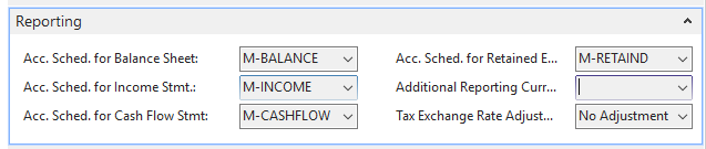

      On the Reporting FastTab on the General Ledger Setup screen in NAV 2018, you can select which Account Schedule to use for your default balance sheet, income statement, etc.Ā  You can select your custom Account Schedule or stay with the “M-” built-in Schedule.Ā  There should be a warning displayed because:Ā  If you “Generate Account Schedules,” NAV will replace/update whatever Schedule that is shown in the GL Setup with NAV’s “M-” version.Ā Ā
      For example, if you adjust your balance sheet G/L Account Categories and then select “Generate Account Schedules” with the intention of updating the M-BALANCE Account Schedule, all Account Schedules named in the GL Setup’s Reporting tab will be changed to conform to the built-in versions.Ā  If you had created a custom income statement Account Schedule and selected it in GL Setup as your Income Statement, it would be lost.
