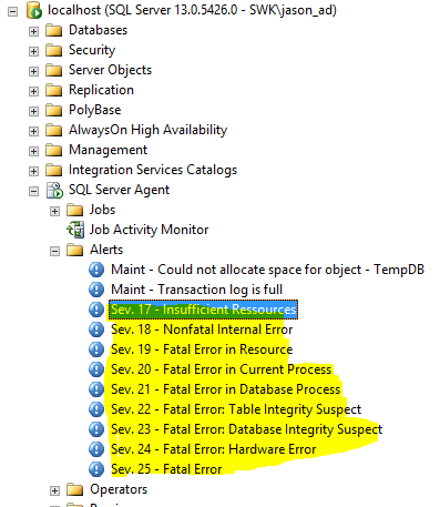

      • You should set up Alerts for Severity 17 to 25 which helps predict hardware failure and fatal errors. Here is a screen showing where to do this under SQL Server Agent:Ā

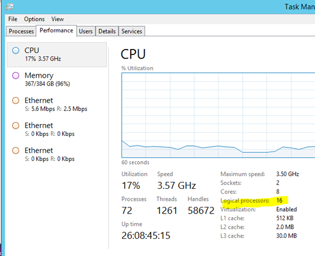

      • In Server Properties, Advanced, “Max Degree of Parallelism” (MAX DOP for short) should be set to half of your logical processors. We have 16 so we set it to 8.Ā  Easy to increase/decrease to optimize performance.Ā  Logical processors can be seen by going to Task Manager, Performance, CPU as seen here:

      • Your TempDB should contain one physical file per Processor. Our SQL partner said “This will alleviate SGAM contention.”Ā  Don’t know what that means but supposedly SQL will automatically assign one process to one file to improve performance.Ā  Though we developers typically use Temp Tables pretty heavily in NAV, that is done in memory on the client machine and has nothing to do with the SQL TempDB database.Ā  I do not think NAV uses TempDB too often so I wouldn’t expect this to change the world for you, but if you know otherwise please tell me.
