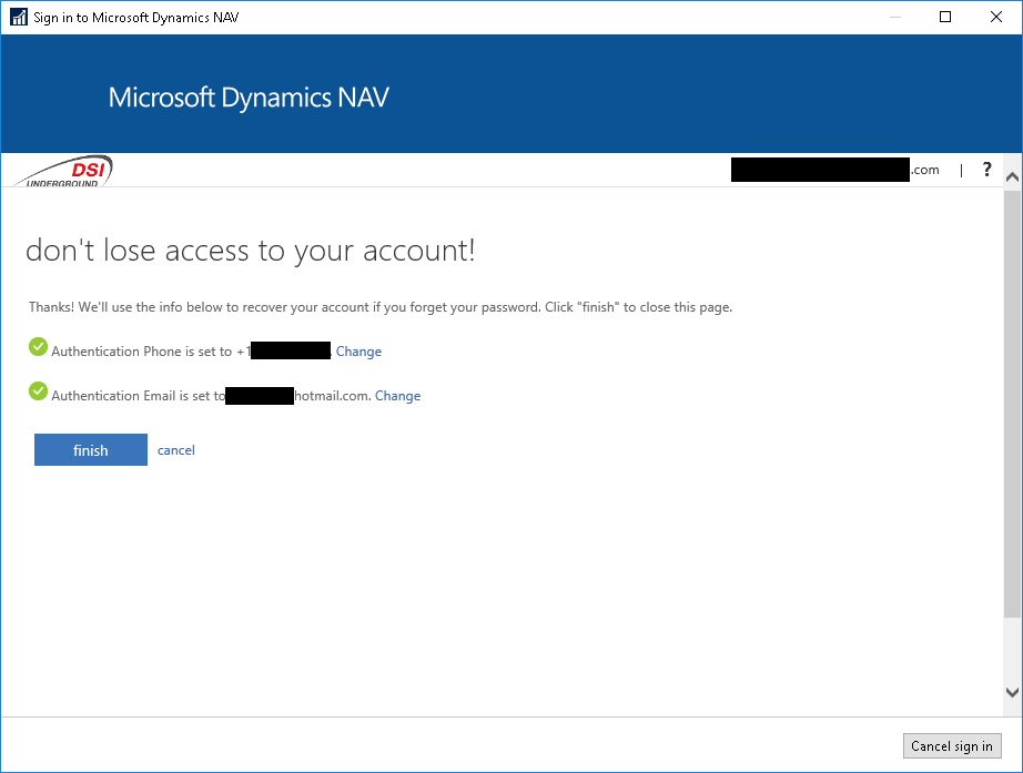

      We are using NAV 2017 on premise with Microsoft Azure.Ā  Just today March 27, 2019 NAV requested that I enter my password again, my phone number, and my personal email.Ā  It would not accept my business email.Ā  So you might say 2-Factor Authentication was forced on us.Ā  Did anyone else have this happen at their work?
      Phone No. and Personal Email
