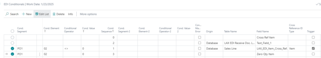

I am assuming these are non-SDQ orders. I ran a test and in my mapping I have the Trigger set on my PO1-07. The quantity comes in on the PO1-02. I setup a conditional on the PO1-07 that says if the PO1-02 = 0, then NO Trigger. If PO1-02 <> 0, then map to the Sales Line “Item Cross Ref” with Trigger = TRUE. See screenshot. Test this out and let us know how it works out for you!
