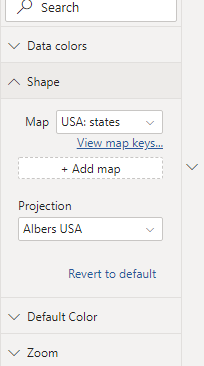

      if you use the shape map visual, under settings, there is a section for new shape or map. It’s the same section that lets you change the built in maps

      Thanks for the response, I see that now.Ā  I still can’t figure out how to get that file imported into PBI though. Am I missing how to download the file or is there a way to import the JSON?Ā  I’m new to PBI so I’m not super familiar with JSON.?

      You have to first make sure you have the actual topo JSON file downloaded, if you downloaded a zip you’ll have to extract it. then from there under options/settings (the little gear) under shape there is an option to add new map
