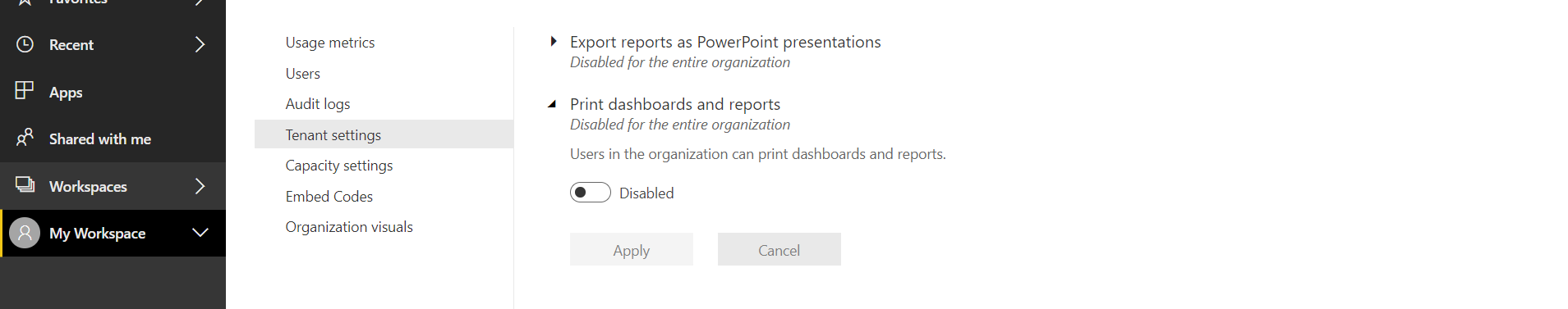

      —If you are sharing reports with other Pro Users you can prevent them from printing out dashboards and reports by going to Settings >Admin >Portal>Tenant Settings>Disable Printing. You will need to have admin rights of the work space in order to control these settings.
      If the reports are shared via PBI Desktop I am afraid you can’t prevent them from being printed.

      1. The ‘Export to PDF’ feature is only available on the Desktop. So if you are sharing the desktop file with the user, you cannot control the printing. As far as printing is concerned on the service, you can print your screen, as in Ctrl+P and print whatever it on the screen. This can be disabled from the setting that I showed in my previous response.
      So I would suggest that you share the files only on the service and yes you can disable them from downloading the PBIX file, provided you have the admin rights.?
