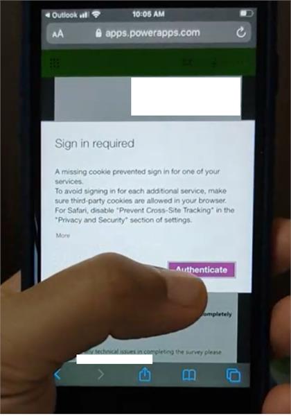

      Also, when a user goes to the PowerApp survey in a phone this pops up,
      I have the “Office 365 Users” added into the data source of the PowerApp. This is just the authentication part. HR want to know if we can delay this from coming up. Reasoning being that the beginning of the Survey takes about 50 seconds to read and this prompt is a distraction apparently as it comes up about 20 seconds after you go to the Survey. This of course I would all depends on Internet connection speed on the phone, etc.
      As far as I know I wouldn’t be able to control when this pops up and it is of course mandatory. Just thought I’d ask anyway if there was anything I coudl do.

      As for the accept message, your IT department can run –> Set-AdminPowerAppApisToBypassConsent -AppName put-the-PowerApps-GUID-hereĀ -ApiVersionĀ

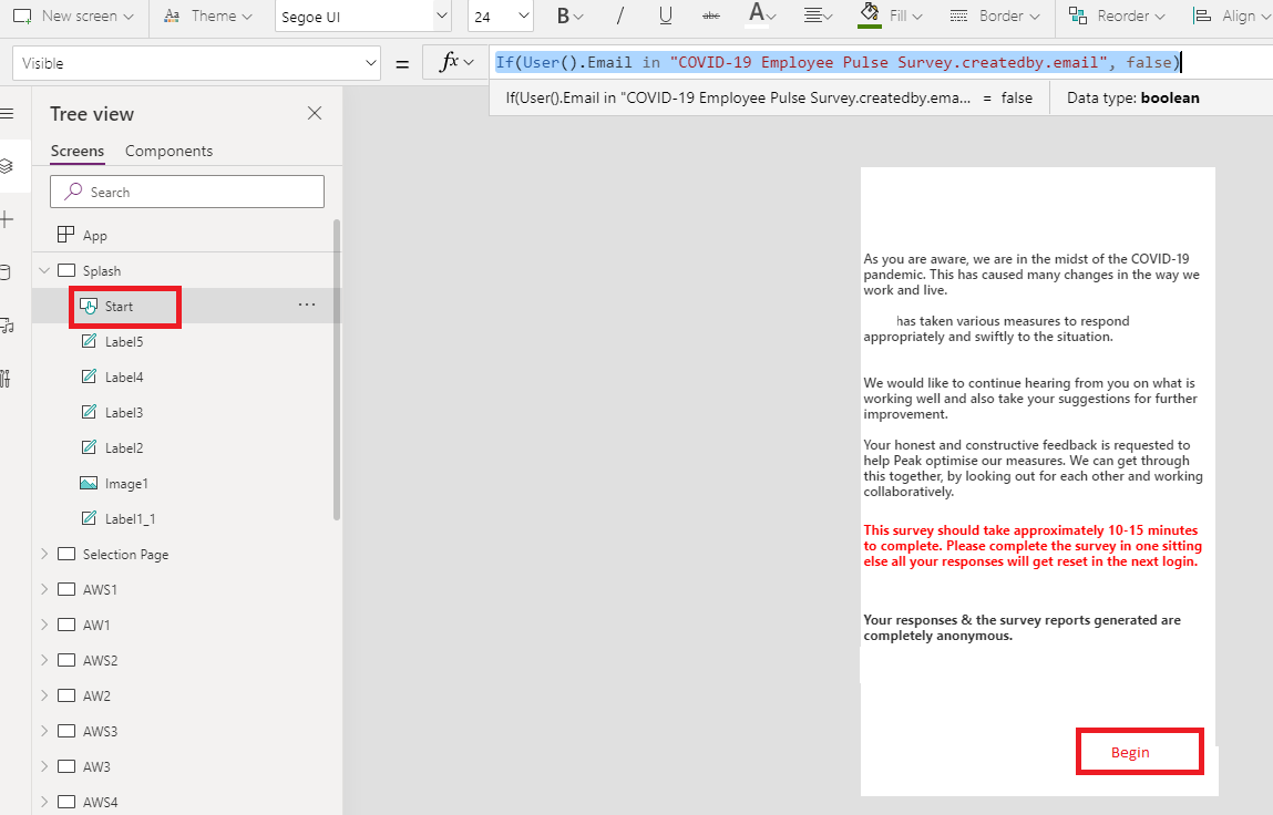

      So my focus here is back on the “Begin” button which kicks off the form initially.
      My SharePoint list is named “COVID-19 Employee Pulse Survey”. It has spaces so I believe I’ll need to use Quotes in the line of code for the Begin button’s “Visible” property. Not sure if I need the URL to the SharePoint list instead of just the name I gave it,
      This is what I have,
      If(user().email in "COVID-19 Employee Pulse Survey.createdby.email", false)
      This doesn’t seem to work. A concern of mine is that when I submit an entry and it goes into the SharePoint list I don’t actually have an Email column there. Just a “Created by” column which is the person’s first and last name such as “John Smith”.
      Can I still use .email even if that property isn’t getting captured and going into the SharePoint list? I guess it’s getting captured with my Office 365 connector in the data source I just mean I don’t see it listed anywhere within any columns.

      Hello. Thanks guys. So I’ve got a couple of issues. I did what Dennis had suggested but I must be doing something wrong as I am getting unexpected results. No matter what, the “Start” button is hidden and I can never see it until I just delete the code and set the value back to true. The start button’s visible property is set to,
      If(User().Email in 'COVID-19 Employee Pulse Survey'.user_email, false)
      On each submission page I have an invisibleĀ form which holds a data card with this value,
      User().Email
      If I un-hide the label I can see my email address in it. I’m patching that form data (my email address or whoever fills this in) into the SharePoint list.
      So basically I did as Dennis suggested and I created the user_email data field. Email addresses are being captured. Once I fill in the form I can see my email address in the user_email column, But for some reason the Begin button won’t appear ever. I would have thought that as soon as I go to the SharePoint list and manually delete my entry, PowerApps would see that my email address wasn’t in the SharePoint list and then display the button. That doesn’t seem to be happening though I am not sure why. I even went and emptied the recycle bin just in case it’s referencing that when it looks.

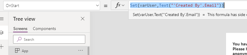

      Luke, thanks for your suggestion. I’ve went to the App’s Startup and entered this,
      Set(varUser,Text("'Created By'.Email"))
      I think I have the syntax incorrect though?
      Then on the actual Begin button’s visible property I have used this,
      If(IsEmpty(Filter('COVID-19 Employee Pulse Survey', 'Created By'.Email = varUser)),false)
      If I am understanding this correctly, right at the beginning of the App we are declaring varUser whatever the person’s email address who is logged into Office 365 doing the form.
      Then the begin button’s visible property is looking at the table and filtering by searching for the varUser variable which will be whoever just submitted the form. Should this work given what I have so far? My tests just don’t seem to show things refreshing in real time. Like I would have expected the begin button to just be invisible until I deleted my entry from the SharePoint list and then as soon as I refresh the data source again within editing the App it will become visible again. I am not sure if I need to save and publish this each time I need to test.

      When you set the variable to store the users email you are just getting the currently logged in users email address not the email address from the data source so set it to:
      Set(varUser, User().Email)
      Then when you use the expression below you are simply returning a set of results where Created By equals the current user and checking if it is empty. The only change I would recommend is setting the value in case it is not empty just in case it defaults to something you are not expecting. I highlighted the change below as well
      If(IsEmpty(Filter(‘COVID-19 Employee Pulse Survey’, ‘Created By’.Email = varUser)),false, true)
