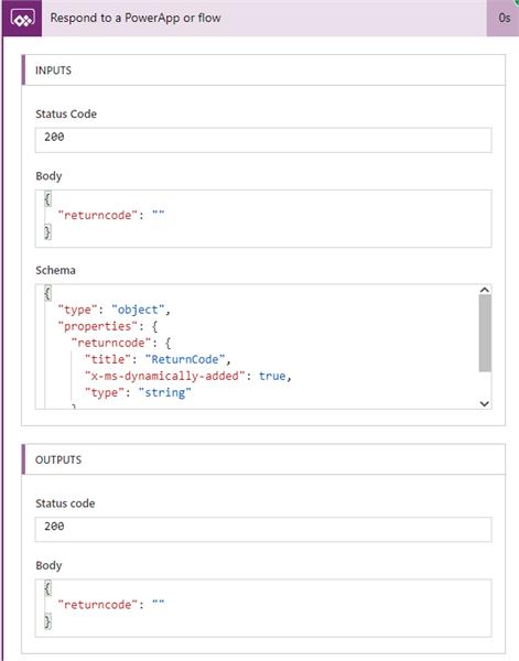

      I can create my flow ok: Triggered by PowerApps button, set static params just for testing. But the output options are very limited.Ā
      Using the “Respond to PowerApp” step, the only option I have in dynamic content is the Return Code. Which, by the way, comes back as an empty string.
      So I get no visible output in my app. I can check the flow status and see the output but there’s nothing useful in there.

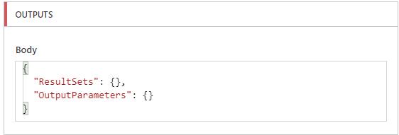

      I did run acrossĀ thisĀ which might suggest that, even though I don’t see the data in the response, it may be present.Ā
      You should be able to get the procedure results with the following expression under Microsoft Flow:
      body('<Action_name>')?['ResultSets']
      Which you may reference the detailed value by adding:
      body('<Action_name>')?['ResultSets']?['FieldName']?
      When I run my flow, I do get a ResultsSets in my output but itĀ appears to be empty. But maybe it’s just indicating it’s an array without showing me what’s in it?
      I just can’t figure out how to get that expression to work to reference the output from the previous step.
