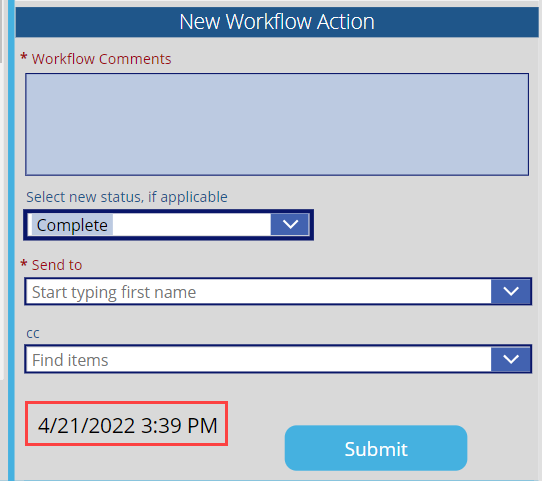

      I have a Power App that uses parent and child SharePoint lists.
      In the child list (CRSP-Workflow), there is a Status drop-down field. If the user selects “Complete,” I need to update the Completion Date field in the parent list (CRSP-Main), which is a DateTime column in the SharePoint list.
      Here’s what I’ve tried.
      In child list form (frmWorkflow):
      • Dropdown is NewStatus (DataCardValue28).
      • In OnChange property of DataCardValue28, I want it to set variable only if the user selects Complete. Otherwise, do nothing. I have tried all of these:
        • If(“Complete” in DataCardValue28.SelectedItems.Value, Set(varCompletionDate, (Now())))
        • If(“Complete” in DataCardValue28.SelectedItems.Value, Set(varCompletionDate, Text((Now()))))
        • If(“Complete” in DataCardValue28.SelectedItems.Value, Set(varCompletionDate, DateTimeValue((Now()))))
      • I have a label on the form containing the variable – with all of these commands, the variable looks correct:

    • Koen Mathijs
      April 22, 2022 at 5:09 AM
      Hi Lisa,
      please try to use the Now() function directly in your Patch statement instead of having it in a variable.
      You could try something like this:
      if(
      Patch(
      ‘CRSP-Main’,varRecord,
      {‘Date Completed’: Now()
      Let us know if this works or not

    • Lisa White
      April 25, 2022 at 11:06 AM
      Thanks, Koen. That worked! Here’s the new code:
      If(
      varCompleted =”Yes”,
      Patch
      Patch
      {‘Date Completed’: Blank()}
