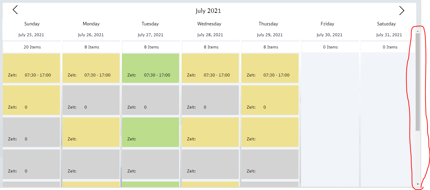

      I am building an app with a nested gallery and i“m currently struggeling with how to set the heights so that the scrolling works fine.
      Here“s how the structure is:
      I have a top gallery which is showing the weekdays (galWochentage). It has 7 items to show the week days / dates.
      Within this gallery, i have sub-gallery to show items from a sharepoint list which belongs to this date (galAuftrƤge).
      My goal is, that you dont have a separate scrollbar for every column, but only one on the right side and that you can scroll until the last item.
      In the Gallery height of the sub gallery, i set the amount of rows * template height –> no scrollbars in the subgallery
      But the scrollbar of the top gallery doesnt scroll until the end but only until item Nr. 7.Ā
      Is it somehow restricted or can i solve that by changing the heights?

      I think, it doesnt work because of a limit of the gallery template height.
      The outer gallery is a horizontal gallery to show the week days in a line. There is no horizontal flexible height gallery available.
      I played around with the template height of the outer gallery, but when i reach a specific height, it doesnt change anymore. Are you aware, if there is any limit value of the template height of a horizontal gallery?
      Do you have any other idea how to achieve my idea?
      I want to show the week days in horizontal (Monday to Sunday) and in every day column, i want to show different amount of items vertical.
      But i dont want to scroll in every single column separately but for the whole week list.
