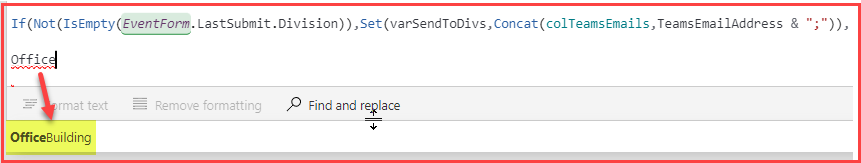

      I created my first customized form in a SharePoint list (integration with Power Apps). I want to send an email when form is submitted. However, when I try to put the code into the Power App Form OnSubmit to send an email, Office365 doesn’t show up as an option:
      Is this not possible, or am I doing something wrong?
      Thanks.

      February 8, 2023 at 1:07 AM
      Hi Lisa,
      You need to add the Office365Outlook connector into your Data Sources.

      February 8, 2023 at 2:12 PM
      Lisa
      You need to:
      Click on data icon, click ‘Add data’, search ‘outlook’ and select ‘Office 365 Outlook’ Add Office 365 Outlook Connection
      Then t will appear in your form propert values.
