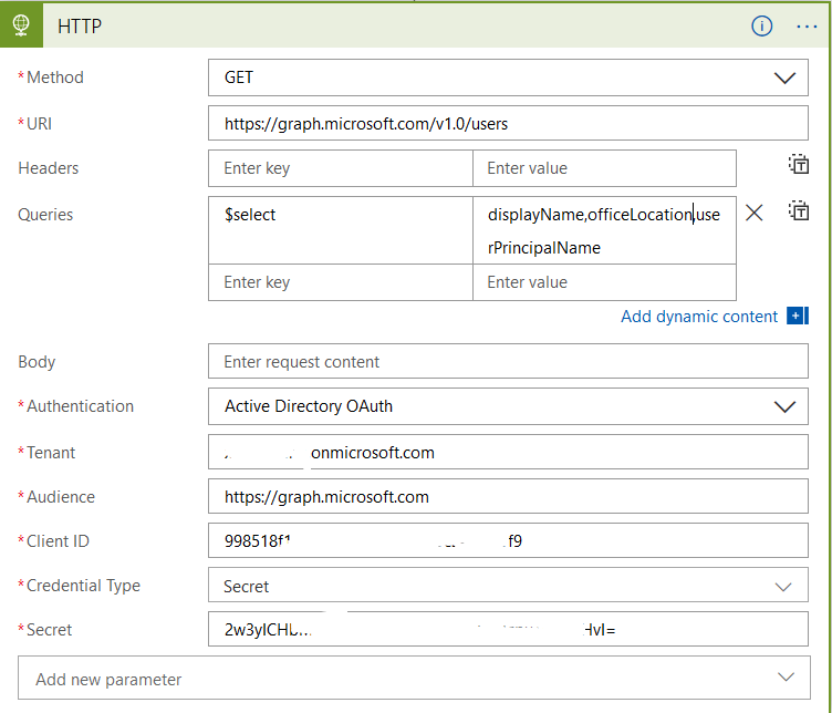

      If you have more than 999 users then the method is a bit different, you have to set up an App Registration for the Graph API in Azure AD then use a Flow or Logic app to hit the Graph using HTTP:

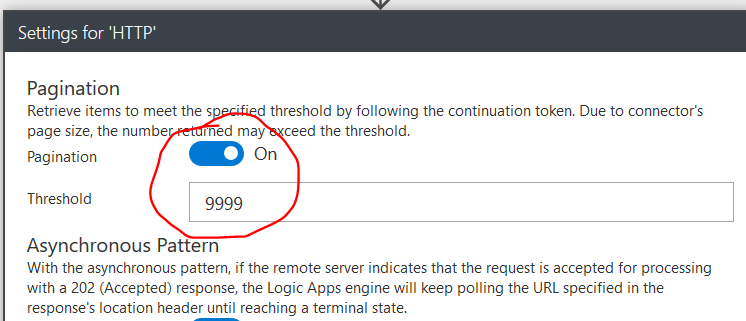

      Hit the 3 dots and go Settings and set the pagination. You can get up 100000 pages of results. By default this means you can have up to 10 million results, but if you’re within a million miles of that then this probably isn’t the solution for your problem!
      Lastly, parse the JSON that comes back and save the results into a delegable data source such as SP online or SQL.
      You can run your flow/logic app on a schedule. Clear out the existing table on each run and repopulate it using get-items, then a for-each to delete them, and another for-each to create the new items. Again, use the pagination setting of get-items to increase the results returned.

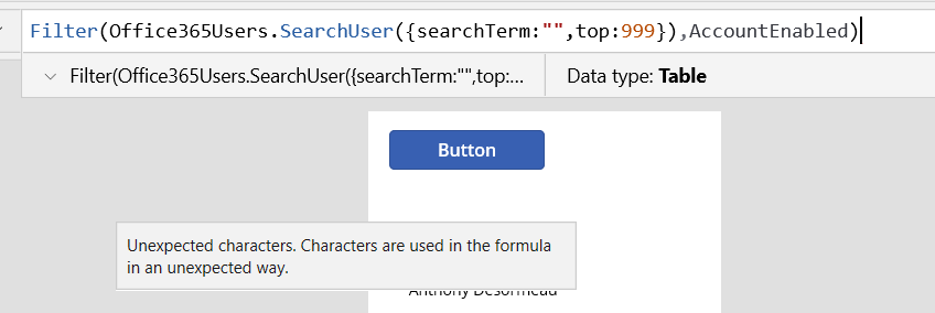

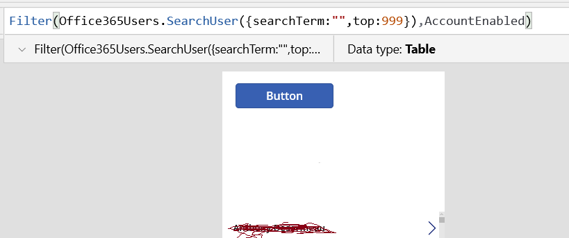

    • Eric Sauve
      May 17, 2019 at 4:35 AM
      Quite a head banger!
      I’ve tried copy / paste the Filter formula as Will posted and I was getting Errors at the end of the formula.. the intellisense was working fine and recognizing all the parameters correctly but somehow no way to remove the unexpected error.
      The only way I’ve been able to make it work was to restart the formula at the SearchUsers part and use the automatic fill for each items in the formula then BOOM it works.. odd!!
