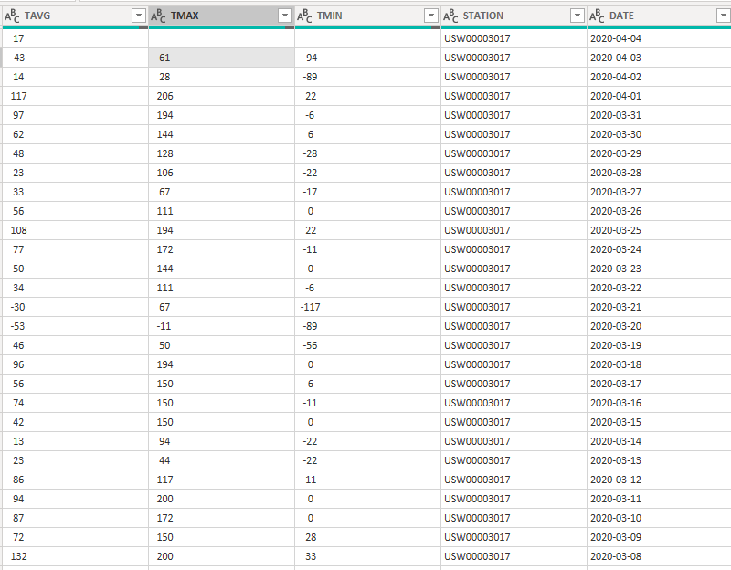

      First off, thank you for your help on this one. What you provided works really well to pull back data. However, I ran into an issue when I looked at the data to verify it. The temperature min and max (TMIN & TMAX) seem to be random and not accurate. (See screenshot).
      This is the Denver international airport weather station. I believe I was wearing shorts on 4/3/2020, I highly doubt the minimum temperature was -94. šŸ™‚Ā
      Do you have any ideas why this data may be pulling back incorrectly?Ā

      It was hard to find, but in the README file that accompanies the dataset states that those TMAX and TMIN values represent temperatures in centigrade, along with the tenth portion of the number. In other words, a TMAX value of 111 is actually 11.1 degrees centigrade. A TMIN value of 100 is actually 10.0 degrees centigrade, and so on.
      Crosswalking the values in this dataset with a sample report from the same weather station, I was able to correctly convert the temperatures to their Fahrenheit equivalents. Here’s an update to the M query that’ll convert both min and max temperatures to Fahrenheit, and also convert the precipitation from millimeters to inches:
