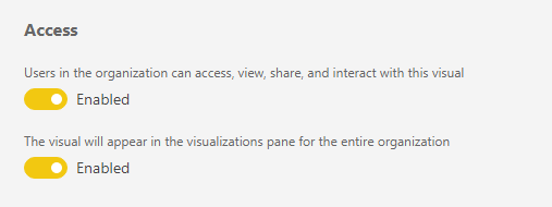

    • Sam Duval
      August 20, 2020 at 10:27 AM
      I also found in the power bi admin portal there is a spot to load custom visuals, and the option to share the visuals with everyone in your organization, so that the visual is loaded for everyone when they open power bi. If you have a visual that’s left appsource, you can back into the a pbix file that has it, and copy the visual out of it and repackage into a standalone power bi visual file.Ā
