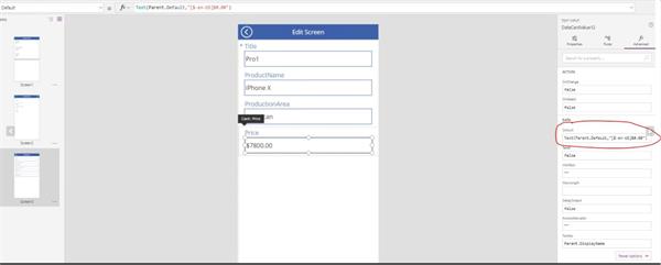

      I have made a test on my side, please take a try with the following steps:
      • Unlock the DataCard where you want to format the field to currency.
      • Within the DataCard, select theĀ TextInputĀ control.
      • Within right panel, setĀ DefaultĀ property to following formula:
        Text(Parent.Default,"[$-en-US]$#,###.00")?
      or
      Text(Parent.Default,"[$-en-US]$#.00")

      I am glad that it worked for you. However??, PowerApps currently doesn’t have that functionality, But if you still want to have that kind of thing there is a workaround you have to include a text control for showing the Dollar Sign ($) in the dollar filed text control.
      If you want to test that, I can tell you about that. But as far as I understand showing Dollar sign is not necessary in the Input form for the New Form as you have already mentioned above Enter Dollar value and when you save it will show you the amount with Dollar sign.
