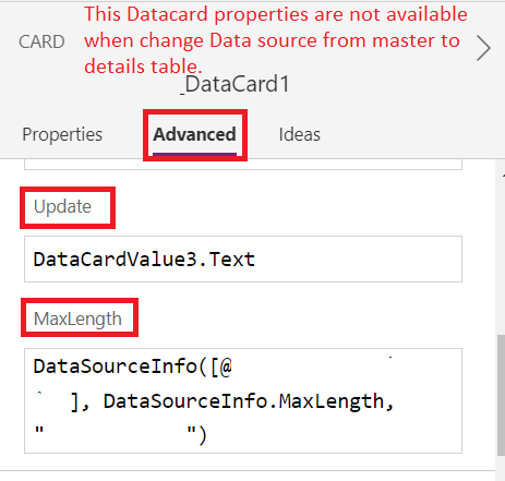

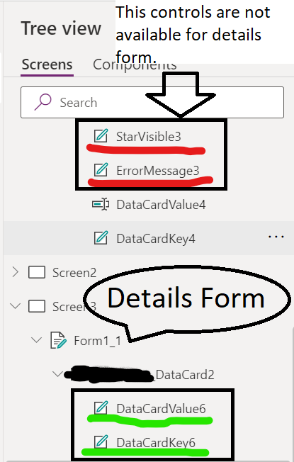

      We can copy existing Edit Form which is in working condition and Paste it in another screen for edit details. So, change data source from master table to details table and add fields which control type is view text / view reach text and no edit text option and Data Card has only two controls DataCardValue and DataCardKey.
